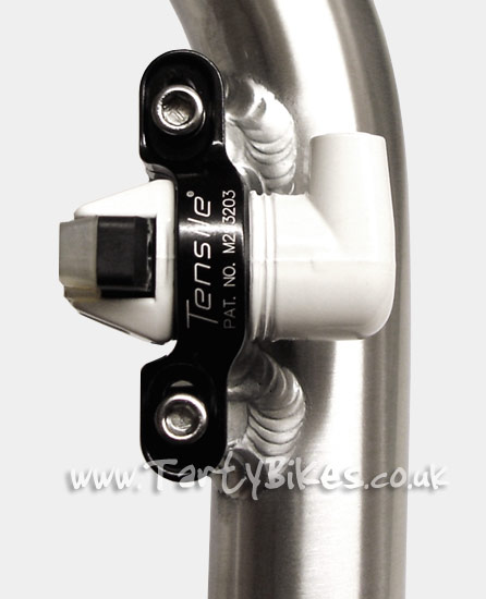

josh barker Posted April 9, 2010 Report Share Posted April 9, 2010 (edited) what brake are you running? if you are running a hs33, if you have tensile mounts. Switch them round the other way Edited April 9, 2010 by josh barker Quote Link to comment Share on other sites More sharing options...
