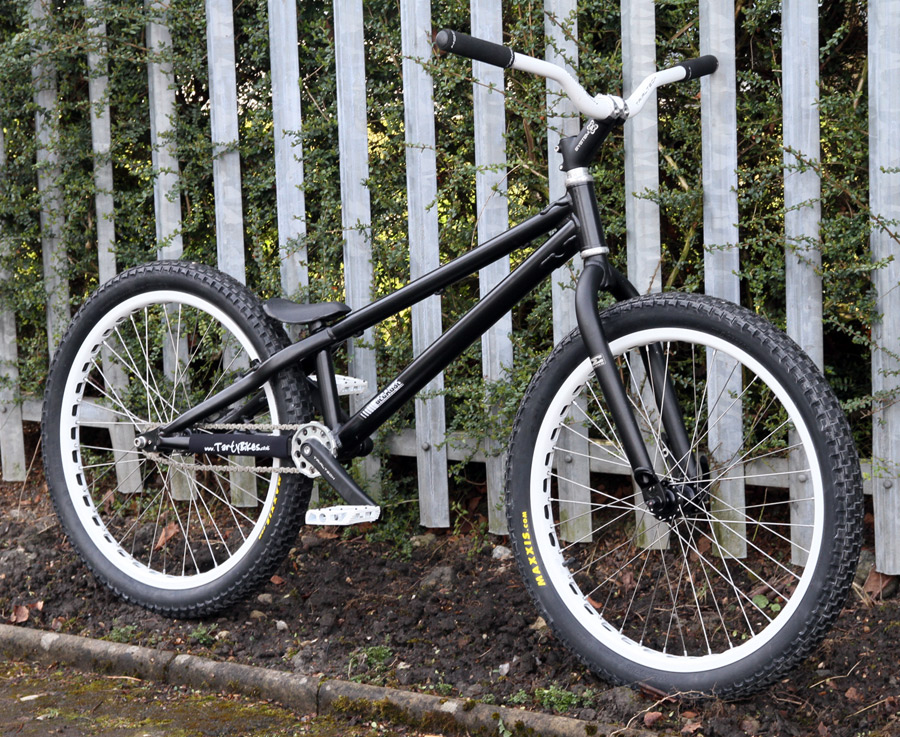

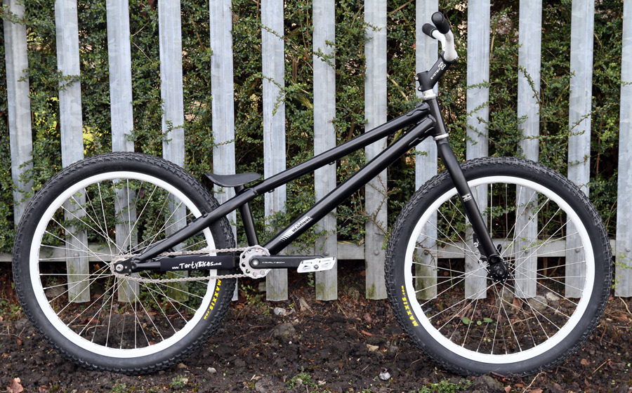

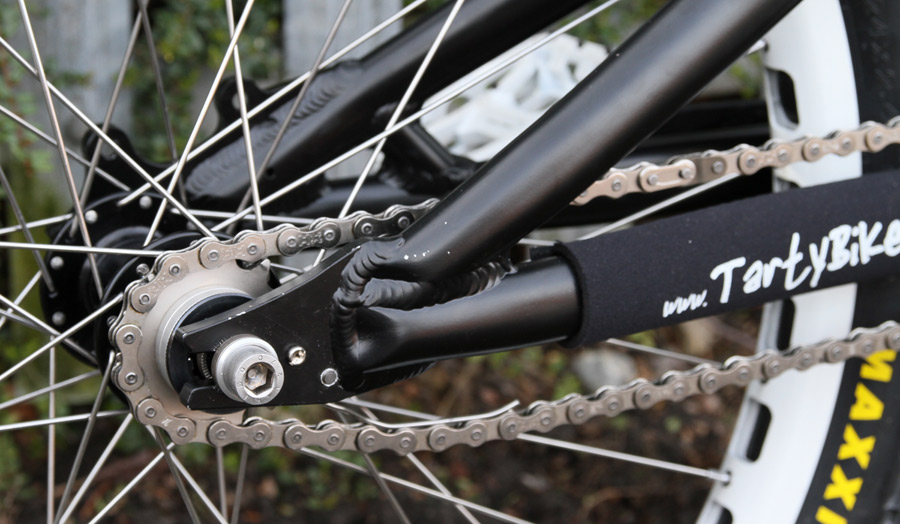

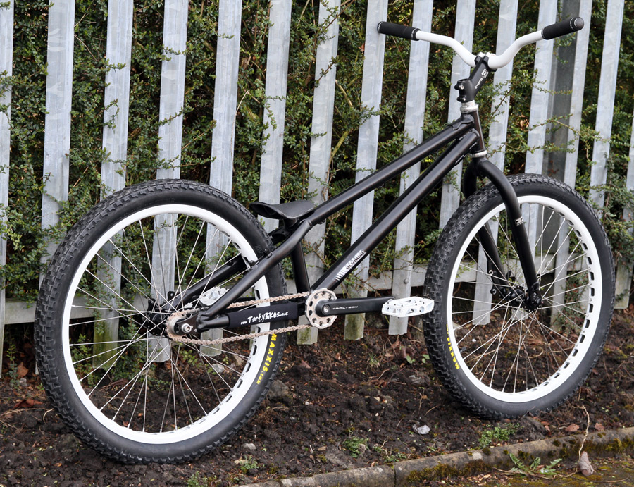

AdamR28 Posted March 26, 2010 Report Share Posted March 26, 2010 Had a couple of brakeless rides on our shop Inspired, then buggered my ankle... but still gonna give brakeless a try. It's refreshing to have to learn all over again after having been riding for so long! Contrary to popular belief, having a brakeless bike is COMPLETELY different to just death-gripping a brake-d bike. Anyone who's been riding a long time and are getting a bit bored of 'normal' trials - I recommend you try this, I'm confident you'll find it very good fun and be surprised at how fast the learning curve is. Anyway, photos... The latest incarnation of the Spoke Tensionerâ„¢ and Pro2 hub modified to 96 engagements. Not had a measure or a ride yet, but geo is around +25, 375, 1050 (would like some Inspired forks to shrink that a bit I think). Bars *look* high but they are actually lower than Stan's Echo as the head tube is quite short. Cheers Adam Quote Link to comment Share on other sites More sharing options...

Franksx2005 Posted March 26, 2010 Report Share Posted March 26, 2010 what you using as a tesioner? Quote Link to comment Share on other sites More sharing options...
AdamR28 Posted March 26, 2010 Author Report Share Posted March 26, 2010 he's ground two pawls down so now it's engaging at 4x1 to give 96. Yeah that's the one, can't really see a reason why it'd die (especially as it's the needle bearing version of the hub), but we'll see Tensioner is a spoke, see photo 6. Quote Link to comment Share on other sites More sharing options...

Franksx2005 Posted March 26, 2010 Report Share Posted March 26, 2010 Tensioner is a spoke, see photo 6. i needed that trick yesterday when my mech hanger snapped. Quote Link to comment Share on other sites More sharing options...
WIGAN Posted March 26, 2010 Report Share Posted March 26, 2010 (edited) one of the nices 24's out there proper have a thing for those frames atm i want 96 ep in my pro 2 but i dont want 96 stitches in my face when it blows up bet it sounds amazing though, and why the need for a tensioner when its horizontal dropout ? Edited March 26, 2010 by WIGAN Quote Link to comment Share on other sites More sharing options...
Mark W Posted March 26, 2010 Report Share Posted March 26, 2010 Can 'slam' the wheel so it's never going to slip forward more, and have the shortest CS length possible, then just wang a spoke tensioner on it. Super easy to use, super light - not really much of a problem. Quote Link to comment Share on other sites More sharing options...

PeanuckleJive Posted March 26, 2010 Report Share Posted March 26, 2010 Can 'slam' the wheel so it's never going to slip forward more, and have the shortest CS length possible, then just wang a spoke tensioner on it. Super easy to use, super light - not really much of a problem. is a spoke tensioner a good idea for a mod? I want to bring the backwheel forward but can't get it all the way, even with a half link Quote Link to comment Share on other sites More sharing options...
AdamR28 Posted March 26, 2010 Author Report Share Posted March 26, 2010 There's three considerations with a mod: - Will the brake mounts still line up - Will there be enough chain wrap around the rear sprocket for it not to skip - Is there is enough space to fit the tensioner in... My gut feeling would be maybe, no, and no... but could be worth a try! The other reason I have one is that it takes any slack out of the chain if the threads on your cranks aren't perfectly concentric, plus when you preload to kick the chain doesn't go all flappy. Quote Link to comment Share on other sites More sharing options...
PeanuckleJive Posted March 26, 2010 Report Share Posted March 26, 2010 There's three considerations with a mod: - Will the brake mounts still line up - Will there be enough chain wrap around the rear sprocket for it not to skip - Is there is enough space to fit the tensioner in... My gut feeling would be maybe, no, and no... but could be worth a try! The other reason I have one is that it takes any slack out of the chain if the threads on your cranks aren't perfectly concentric, plus when you preload to kick the chain doesn't go all flappy. Good point, good point, and good point Guess i'll stick to how it is Quote Link to comment Share on other sites More sharing options...

Franksx2005 Posted March 26, 2010 Report Share Posted March 26, 2010 Can 'slam' the wheel so it's never going to slip forward more, and have the shortest CS length possible, then just wang a spoke tensioner on it. Super easy to use, super light - not really much of a problem. What is the spoke wrapped around? im very interested in this, you need to post a how too lol. Quote Link to comment Share on other sites More sharing options...
AdamR28 Posted March 26, 2010 Author Report Share Posted March 26, 2010 What is the spoke wrapped around? A custom 'boss' I made. You can wrap it around the axle too, but you may run into the same problem I described above - not enough room. Quote Link to comment Share on other sites More sharing options...

Ollie Histon Posted March 26, 2010 Report Share Posted March 26, 2010 I still don't trust this spoke thing you've got going on, what if your pedaling backwards and it slips into the chain? Quote Link to comment Share on other sites More sharing options...
AdamR28 Posted March 26, 2010 Author Report Share Posted March 26, 2010 I still don't trust this spoke thing you've got going on, what if your pedaling backwards and it slips into the chain? It doesn't - the end of the spoke is bent up: Quote Link to comment Share on other sites More sharing options...
