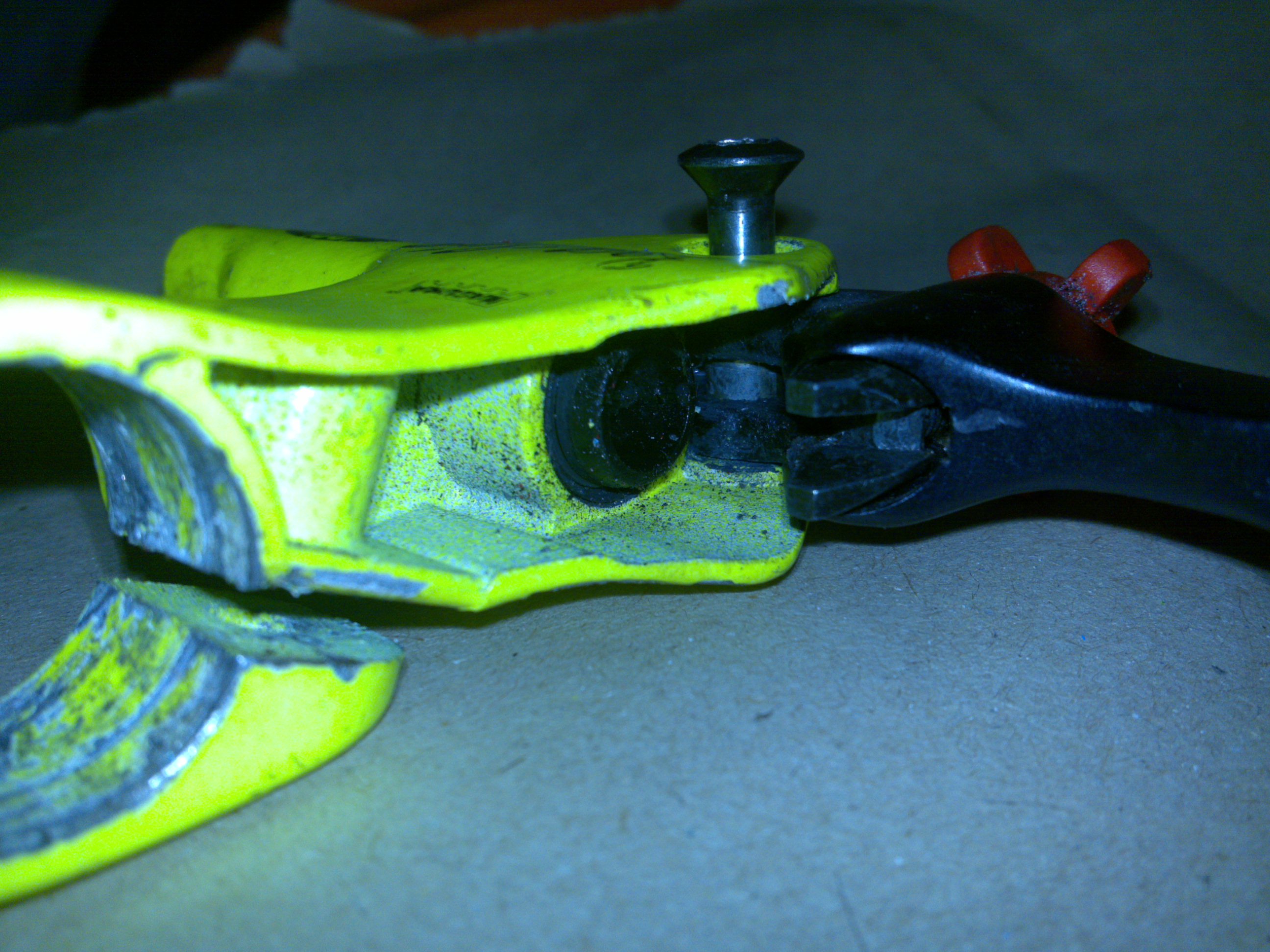

jt123 Posted March 23, 2010 Report Share Posted March 23, 2010 Firstly massive thanks to 'happydaze' as I've just got a set of maggies for £2. But my question is, what part am i missing from the lever. I'm new to maggies so have no idea about them, but when i put the lever together to see if there was anything missing that I would have to buy, it seems like there should be a bit between the actual cylinder and the lever. Also, it is a front lever but could I run it upside down on the right as a rear? Quote Link to comment Share on other sites More sharing options...
monkeyseemonkeydo Posted March 23, 2010 Report Share Posted March 23, 2010 Two bits- one is the plunger that actually pushes on the piston and the other is the plate which is adjusted by the TPA and then locks onto the plunger. Not sure if these are available separately anymore though... I probably have both bits in the garage if you needed. Quote Link to comment Share on other sites More sharing options...
jt123 Posted March 23, 2010 Author Report Share Posted March 23, 2010 Two bits- one is the plunger that actually pushes on the piston and the other is the plate which is adjusted by the TPA and thenlocks onto the plunger. Not sure if these are available separately anymore though... I probably have both bits in the garage if you needed. If I could have them mate that would be ace. I've just checked tarty, CRC, ebay and searched google with no success other than buying a whole new lever. Quote Link to comment Share on other sites More sharing options...

monkeyseemonkeydo Posted March 23, 2010 Report Share Posted March 23, 2010 Hey mate, just been in the garage and dug out the bits. PM me your address and I'll get them sent out tomorrow morning . Quote Link to comment Share on other sites More sharing options...
jt123 Posted March 23, 2010 Author Report Share Posted March 23, 2010 Hey mate, just been in the garage and dug out the bits. PM me your address and I'll get them sent out tomorrow morning . PM sent. Thanks loads dude. Quote Link to comment Share on other sites More sharing options...
