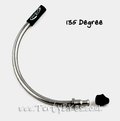

Muel Posted March 11, 2010 Report Share Posted March 11, 2010 (edited) Looks to me that the arms are at this kinda angle. \ / If you put thinner spacers in between the pads and the arms then the arms will be more | | like that, and the cable will be higher. If you also move the mounts right to the top it might sort it. EDIT: Also could do better with a 90 degree noodle to stop the cable being pushed down to the tyre. Edited March 11, 2010 by Muel Quote Link to comment Share on other sites More sharing options...

Mikey-uk Posted March 11, 2010 Author Report Share Posted March 11, 2010 (edited) Looks to me that the arms are at this kinda angle. \ / If you put thinner spacers in between the pads and the arms then the arms will be more | | like that, and the cable will be higher. If you also move the mounts right to the top it might sort it. EDIT: Also could do better with a 90 degree noodle to stop the cable being pushed down to the tyre. I'll try this tomorrow, cheers mate. I still have about 2ft extra cable to cut down so it looks like more fun times.... Yay ¬_¬ Edit* It is a 90degree noodle... It's some new style flexy noodle though, giving it a try out. Edited March 11, 2010 by Mikey-uk Quote Link to comment Share on other sites More sharing options...

Borat Posted March 11, 2010 Report Share Posted March 11, 2010 Your cable isnt slotted into the noodle properly, and you need to bend the noodle, to a 9degrees angle mate. If not, and I have cash to go, I'll sort it in reading, sunday? Quote Link to comment Share on other sites More sharing options...

Canardweb Posted March 12, 2010 Report Share Posted March 12, 2010 (edited) I had exactly the same problem! Only solution: bend your noodle a bit like that: http://www.tartybikes.co.uk/images/large_avid135.jpg Edited March 12, 2010 by Canardweb Quote Link to comment Share on other sites More sharing options...
