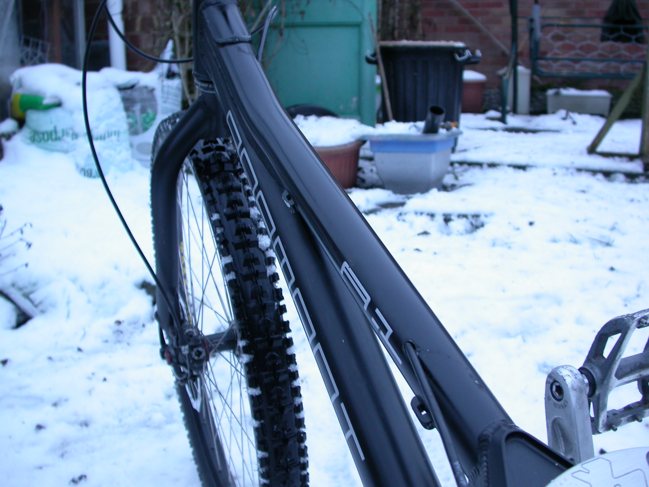

matthew_coggan Posted February 21, 2010 Report Share Posted February 21, 2010 As you can see in the picture there is quite alot of a bend from where the cable leavs the frame to where it coes on the calliper at the back you need to try and reduce this angle for the brake to feel better. Quote Link to comment Share on other sites More sharing options...
matthew_coggan Posted February 21, 2010 Report Share Posted February 21, 2010 (edited) Sorry about last pic was shit hope this one is better As you can see in the picture there is quite alot of a bend from where the cable leavs the frame to where it goes on the calliper, at the back you need to try and reduce this angle for the brake to feel better. Edited February 21, 2010 by matthew_coggan Quote Link to comment Share on other sites More sharing options...
