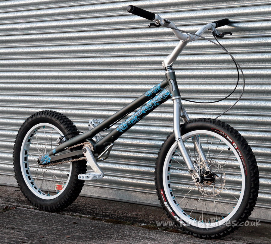

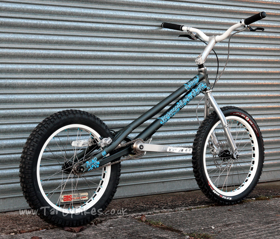

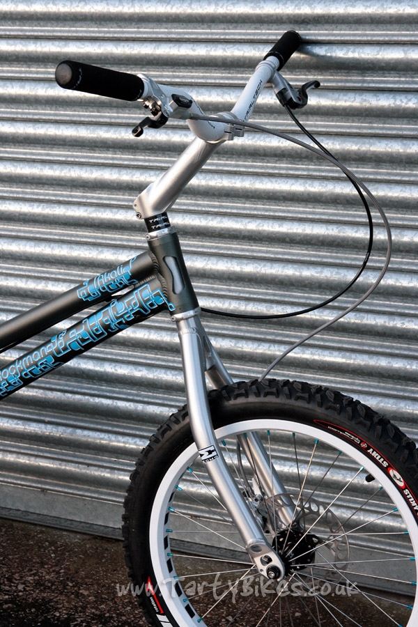

Stan Shaw Posted February 10, 2010 Report Share Posted February 10, 2010 (edited) Specced this beast out this morning and Ali built it this afternoon. Pleased with how it came out Full spec to follow on the site in the morning. Weight: 8.40kg Geo: 1000mm, 350mm, +80 BB, 595mm reach. Edited February 10, 2010 by Stan Shaw Quote Link to comment Share on other sites More sharing options...

walker Posted February 10, 2010 Report Share Posted February 10, 2010 Looks smart! Can't believe how high that front end is!! Mahoosive risers, long stem and stackers, crazy! Quote Link to comment Share on other sites More sharing options...

Stan Shaw Posted February 10, 2010 Author Report Share Posted February 10, 2010 (edited) Looks smart! Can't believe how high that front end is!! Mahoosive risers, long stem and stackers, crazy! The front end isn't really that high at all. The Try-all stem has 150mm x 30° geo which is fairly low for a mod stem. The High Rise Trialtechs make up the rest of the height and the stem stackers are to compensate for the low stack height of the stem clamp. Also you need to remember the BB is +80, which is higher than most mods, therefore you need to match it. It feels really nice when your on it. Edited February 10, 2010 by Stan Shaw Quote Link to comment Share on other sites More sharing options...

Mark W Posted February 11, 2010 Report Share Posted February 11, 2010 The distance from the BB height to the bars on the Akali is about 4-5mm shorter than on a comparable Aurem spec, so it's not particularly high... Quote Link to comment Share on other sites More sharing options...

Ollie Histon Posted February 15, 2010 Report Share Posted February 15, 2010 hows that stem work then? do you have to take your levers off when removing the bars? Quote Link to comment Share on other sites More sharing options...
