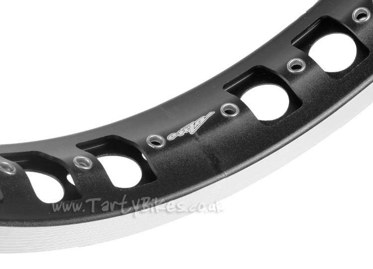

crispyboy Posted January 25, 2010 Report Share Posted January 25, 2010 Hello everyone i have a double walled onza Pro series rim and was thinking of Filing the 2nd wall out to Square just like the 1st wall. I recon it would look rather good. How hard would it be ? What Tools ? Would it be to weak after ? Quote Link to comment Share on other sites More sharing options...

willis-gu Posted January 25, 2010 Report Share Posted January 25, 2010 When i done my front hog rim to squares, i used a rounded circle file to get the ain shape, like filed to each corner because its quicker when using the circular file. The i made the square shape and filed all edges straight with a basic square file. Picked up a set of 3 files from B&Q for £5 Quote Link to comment Share on other sites More sharing options...
Duncy H Posted January 25, 2010 Report Share Posted January 25, 2010 I once did it to a try-all rim with a dremel and then neatened up the edges with a file. Was still time consuming but looked good afterwards. Quote Link to comment Share on other sites More sharing options...
crispyboy Posted January 25, 2010 Author Report Share Posted January 25, 2010 Right what about taking the 2nd wall out ? Its a rear and dont want to weaken it to much ? Quote Link to comment Share on other sites More sharing options...
Borgschulze Posted January 25, 2010 Report Share Posted January 25, 2010 That rim is already nearly as light as a Try-All H0le, just be happy with the weight of it. I'm willing to bet it won't last if you start weakening it, it's probably quite thin compared to other rims since it's so light, double wall, and eyeletted. Quote Link to comment Share on other sites More sharing options...
ogre Posted January 25, 2010 Report Share Posted January 25, 2010 take out the 2nd wall, buy a dremel, and a file, cut the inner wall out, a section at a time, make sure you're in no rush to get it done cause if you rush you'll f**k it up + loose the rim, then use a file to smoothen off any burs and away you go, pretty obvious really? plenty of people have single-walled a rim, not worth it if your a basher though... Quote Link to comment Share on other sites More sharing options...

Bigman Posted January 26, 2010 Report Share Posted January 26, 2010 I will be honest and say that it is surprising how well a single walled rim will last! I am running a try-all hOles rear rim on my 26inch and i am 125kg!! I have had it for 6 months now and it has barely gone out of true and only as one VERY small flatspot! From what I understand Ryan you are a fairly light rider, you might get away with the rim single walled. Filing the rim out will not take that long though as it is only one skin that has to be removed, I would say it would be possible within an hour or so if you realy go for it Unfortunately most people do not have access to a milling maching like I do...... Adam Quote Link to comment Share on other sites More sharing options...

crispyboy Posted January 26, 2010 Author Report Share Posted January 26, 2010 Ive done it now. Dident take me that long either What do you all think ? Quote Link to comment Share on other sites More sharing options...
Alex Dark Posted January 26, 2010 Report Share Posted January 26, 2010 Ive done it now. What do you all think ? Looks ace...good luck keeping it dent free Quote Link to comment Share on other sites More sharing options...
