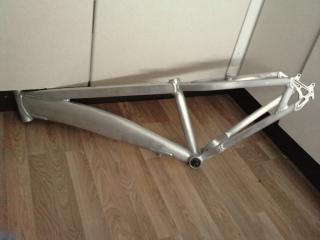

willis-gu Posted January 24, 2010 Report Share Posted January 24, 2010 Basically, rawing the frame down to silver, however i dont know what to use. I have been told oven cleaner works, but a little try seems like it will take hours to do. I have also been told to use nitromoss but i am not sure if it is any good or how long it will take using it! So i want something quick and easy, which will sort the job right out!! Anyone got any little tricks or ideas? Anyone recomend anything? thanks, willis x Quote Link to comment Share on other sites More sharing options...
