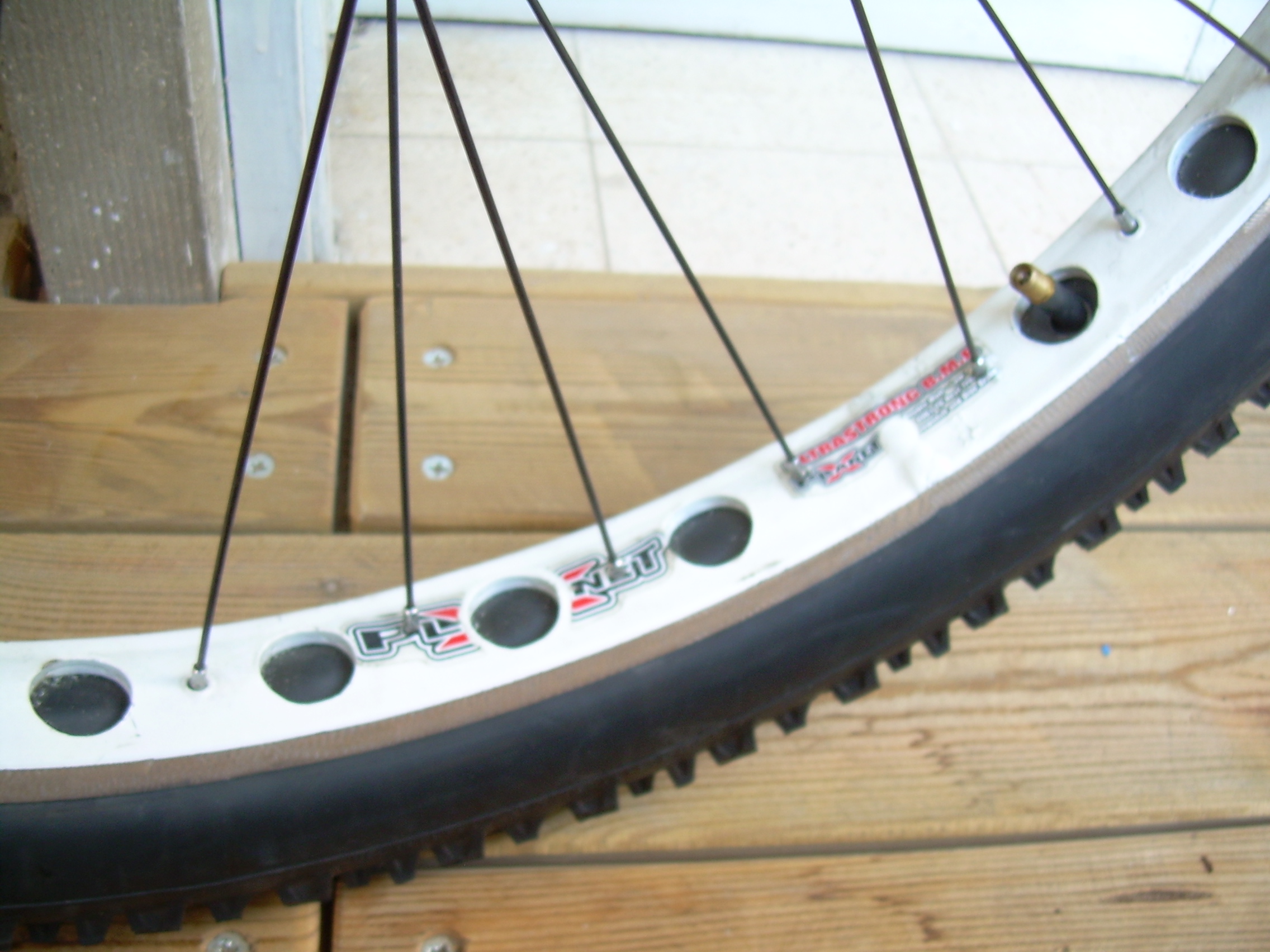

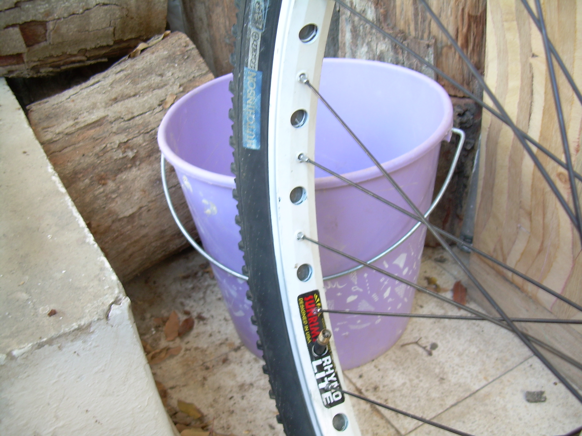

Matt Vandart Posted January 27, 2010 Report Share Posted January 27, 2010 Quote Link to comment Share on other sites More sharing options...
Alex Dark Posted January 27, 2010 Report Share Posted January 27, 2010 Haha so pointless....unless they're pilot holes for >10mm holes Quote Link to comment Share on other sites More sharing options...
Matt Vandart Posted January 27, 2010 Report Share Posted January 27, 2010 Haha so pointless....unless they're pilot holes for >10mm holes Don't be daft they are obviously pilot holes, couldn't be arsed to put the next picture on because it would be the same just with a bigger drill. Quote Link to comment Share on other sites More sharing options...
