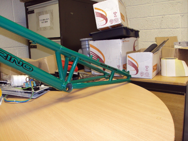

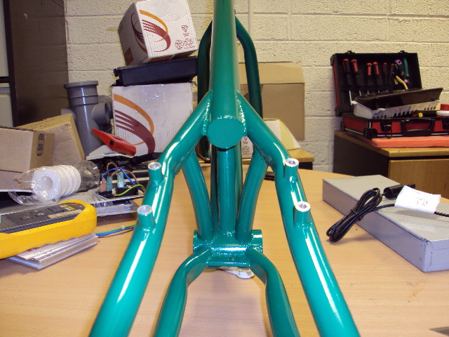

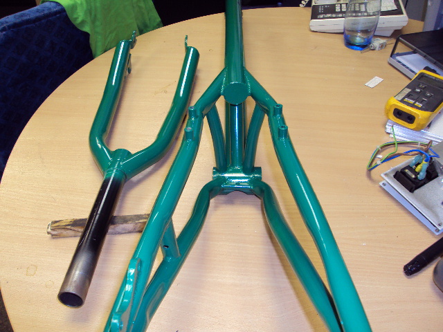

darrenhopper Posted January 14, 2010 Report Share Posted January 14, 2010 Morning all, I got astock frame sent across late last year, just before everything froze over. So I've not had much more than a kitchen session on it. The steel is alot more spring-y but it is a little heavy. I wouldn't buy a fork from him again. The one I recieved reminds me of an old Raleigh MAX fork. It's a long way too heavy & unfortunately he got the +20mm mount wrong so I had to chop it up & make my own. I had a rear disk mount added as well & have not checked to see if it is in the right spot. I'm using a maggy. Contact was good and regular through the build process. Once he'd told me the frame was built I had no contact for a few weeks but then out of nowhere he sent me a tracking number & the frame arrived in good time. The build quality is pretty good, all of the welds are perfectly acceptable. Better than mine in alot of cases! If you go for horizontal drop-outs, he offers a wee welded on pair of tensioners. These wouldn't work with a freewheel on my DMR hub. I had to go to front freewheel and a fixed screw on rear sprocket because it doesn't protrude out over the axle where the tensioner screw was to touch. The clearance on the chainstay & seatstay wouldn't allow me to run a 24t Middleburn chainset either (the chain fouled the frame), so again FFW was the only way around it. I had minor problems with an ENO fouling the frame around the BB but I think that's normal for any FFW & ENO, right? If you need to know anything else, send me a PM. I can get you some snap shots of anything you're concerned about too if you'd like. Quote Link to comment Share on other sites More sharing options...

darrenhopper Posted January 14, 2010 Report Share Posted January 14, 2010 Darren if your eno was fouling on the chainstay/BB yoke are then surely you needed a longer bb to give the clearance needed? Nah, it was the removal tabs fouling on the BB shell when I had a bashring on but I moved that to between the BB & Frame. Actually come to think of it that was another problem I had... Marino only threaded the first 10mm or so of the BB shell so the longer threaded section on my BB wouldn't go in past that. Fortunately I have a BB tap so I just made the threads go in further. I'll get you some snaps this evening & post tomorrow when I'm being paid for it! Quote Link to comment Share on other sites More sharing options...
darrenhopper Posted January 15, 2010 Report Share Posted January 15, 2010 Morning, I forgot to take photos for you but the ones (I think) I've attached are the frame when it arrived. Quote Link to comment Share on other sites More sharing options...
craigjames Posted January 15, 2010 Report Share Posted January 15, 2010 (edited) Frame looks lovely, love the design and the colour. Although nothing looks aligned exactly ("seat tubes", BB yoke area etc.... but then it is filthy cheap so small defects on a hand built frame at this price point can be expected.. Is everything all Ok clearance wise? Have you measured up the geo and compared it to what you ordered? Don't mean to sound an arse just trying to find out how good for the money they are . Edited January 15, 2010 by craigjames Quote Link to comment Share on other sites More sharing options...
Luke Rainbird Posted January 15, 2010 Report Share Posted January 15, 2010 Looks as well designed as any Deng frame out there... Quote Link to comment Share on other sites More sharing options...
darrenhopper Posted January 18, 2010 Report Share Posted January 18, 2010 I did measure it as it happens. I was only using a cheap inclinometer for the head angle but it measured up bang on. The photos really don't do the build quality justice. Everything is in pretty good alignment. Aside from getting the +20mm disk mount wrong on the fork, everything was tickety boo. I would buy another, if only because steel frames are fantastic! Quote Link to comment Share on other sites More sharing options...
