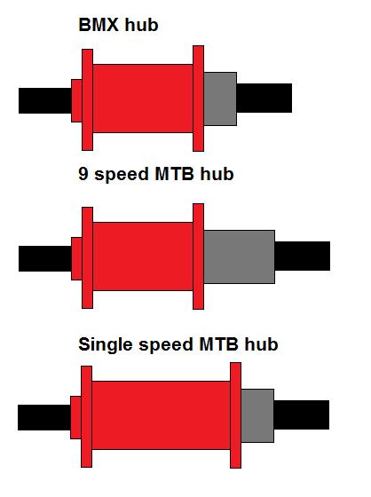

"Wrong," the hub shell on the BMX hub, is different to the one on the MTB single speed hub, however it is the same on the 9 speed mountainbike hub and the BMX hub, the cassette body may well be the same on the BMX hub as it is on the MTB single speed hub.
If you need any proof look at the distance between the spoke flanges, it's 57mm on the BMX hub's and the 9 speed MTB hubs, and it's 67mm on the single speed MTB hub.
So there is no set up that needs just the axle swapping, it either needs the axle and cassette body swapping, or the axle and hub shell. I'd imagine each of the 3 versions will have it's own specific axle, due to the bearings positioning.
You're right about the BMX hubs being the standard 110mm, and that 116 is just a weird size invented by trials companies, the idea being you use a 110mm hub, with a 3mm thick snail cam either side of the hub.
Just to clear things up, have a paint drawing :P
have got a second hubshell is loads wider may just be bolts and axle now
Sounds good, if it's wider, then it's the shell from a SS mountain bike hub, meaning with the right axle, and your old cassette body it may well all go together nicely. Although I have no proof/experience to say that the cassette body will be the same, it would make sense from a manufacturers point of view to share the same part between the 2 models to keep tooling costs down.
Whoops, I was thinking cassette body. Got all engrossed in the whole BMX spacing being 116...my apologies.
