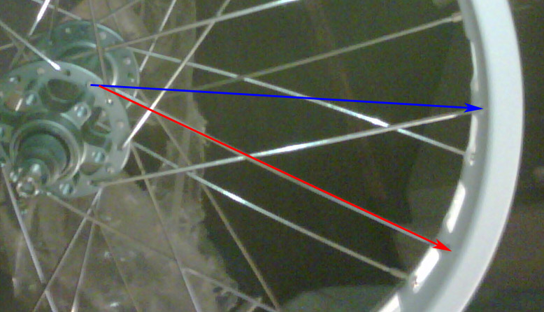

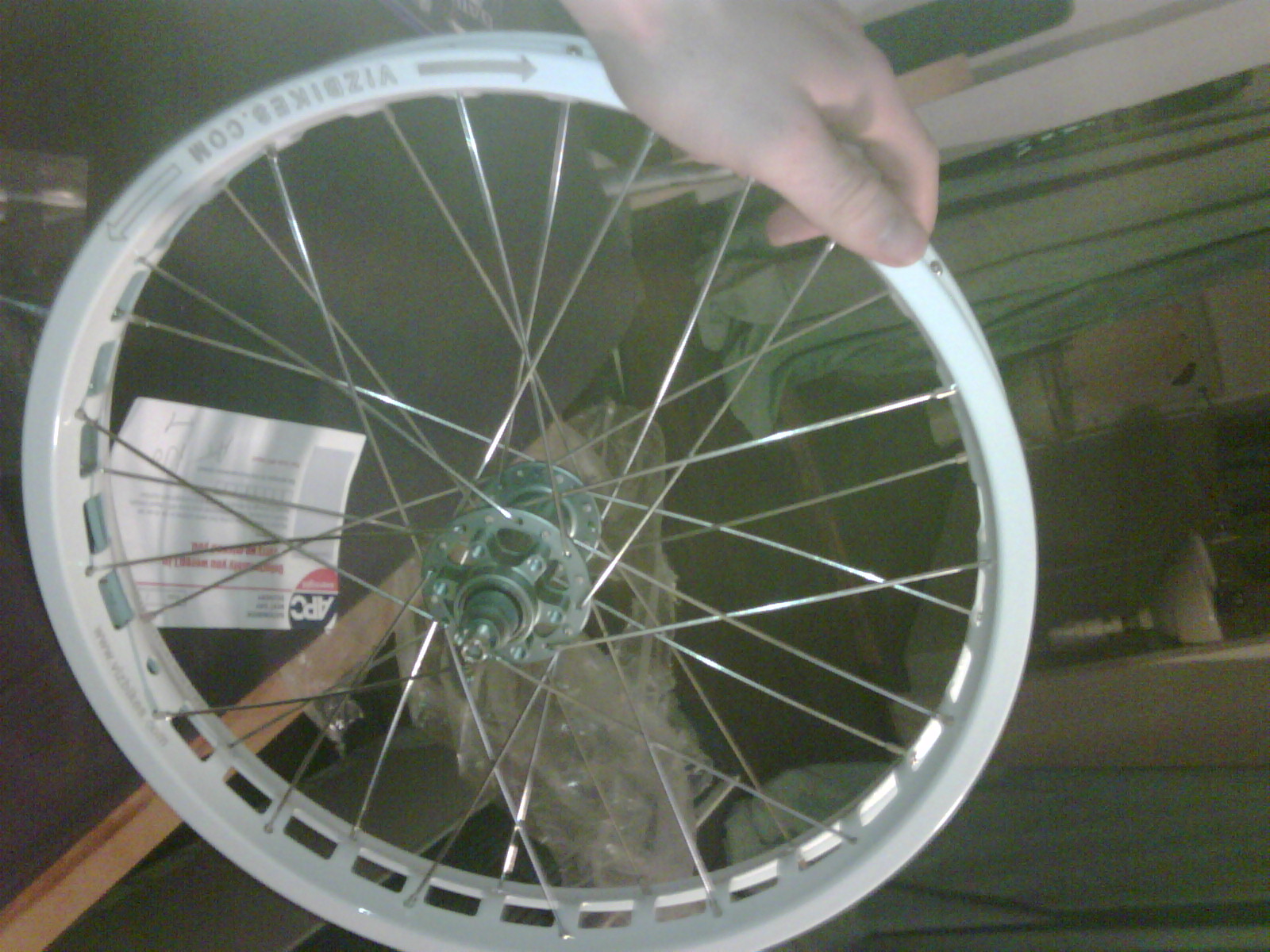

it gose 2 spokes stick out to much then 2 normal then 2 stick out to much all the way around some help please ..
Means you've laced it wrong... One side of spokes is one hole 'out' in relation to the other side. Check the lacing again, right from the first spoke.
Usually easier to strip it and start again (Y)
the holes are ofset do i have to cross over say left side of hun to right side of spokes?
Nah, just lace it correctly ;)
'Red' spoke should be in 'blue' position (and then all the spokes on that side of the hub need to go round the rim the same distance). Easiest way is to re-lace....
