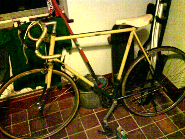

Are they racing bikes, or road bikes? I have no idea.

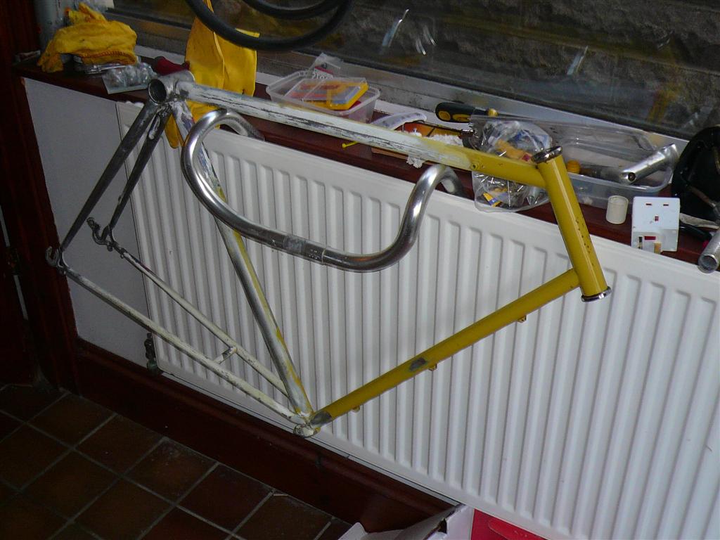

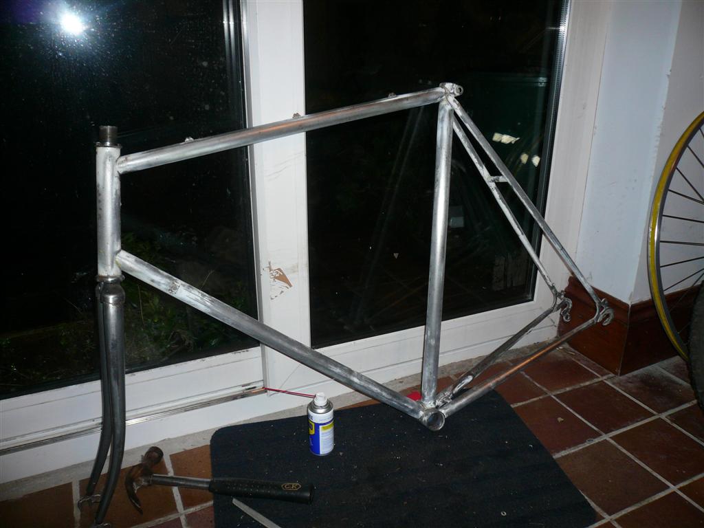

Anyway, I got it off ebay for £20. I have no idea what it is (the auction said 'brookes racing bike', but I don't think brooks (no 'e') make bikes - only saddles?).
Currently stripping it down, which is a complete f**ker.. its got some white primer on it which nitromors doesn't touch. It looks like someones tried to strip it before.. so theres patches of this white primer that I'm wet and drying off of it... must have spent a total of around 10hrs on it so far.

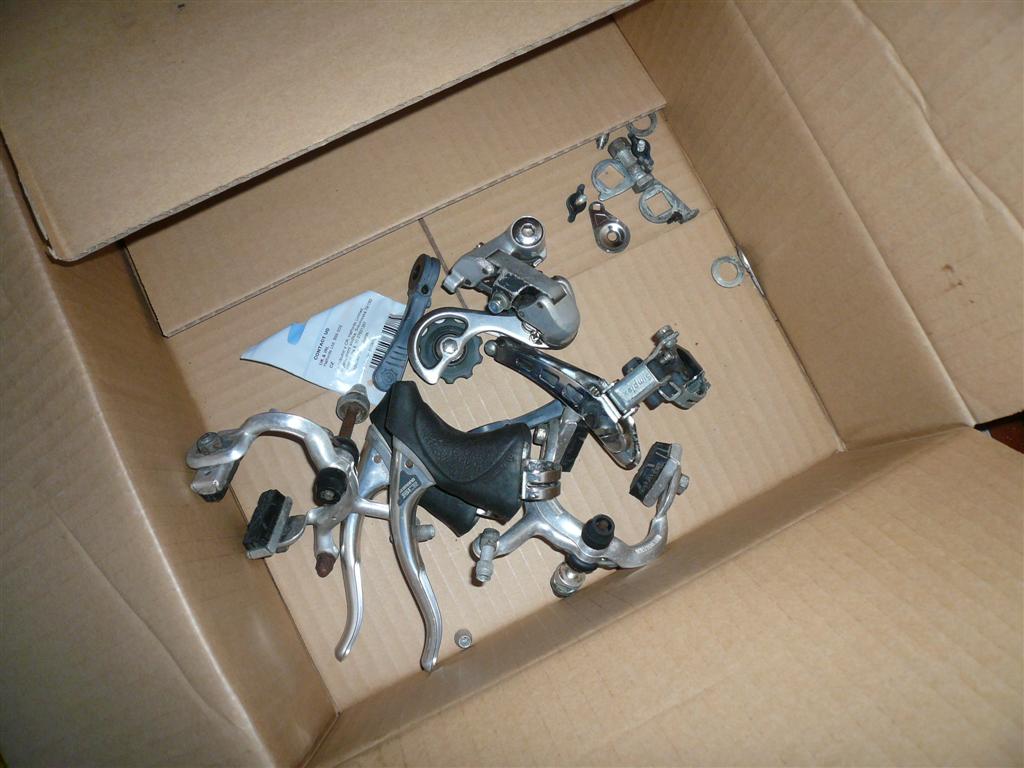

New things for it:
<ul><li>cranks (the extracting thread is ruined on the drive side crank, so not putting that back on)</li><li>new inner/outer cables (white)</li><li>new saddle</li><li>headset (the old one is rusty and beyond de-rusting)</li><li>tyres</li><li>downtube shifters - chrome ones instead of black plastic</li><li>paint - very dark pearl blue methinks.</li></ul>Everything else I'm keeping as it was.

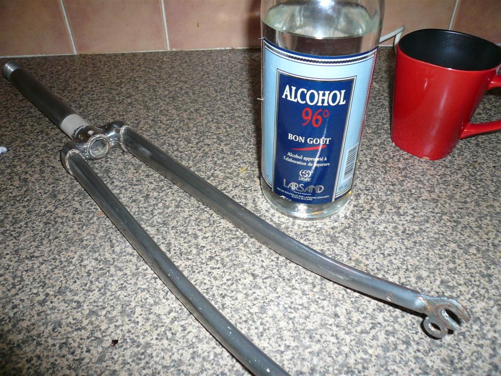

A clean with alcohol

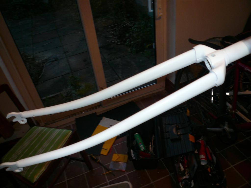

2/3 coats of primer, wet and dried (ooh so loverly and smooth)

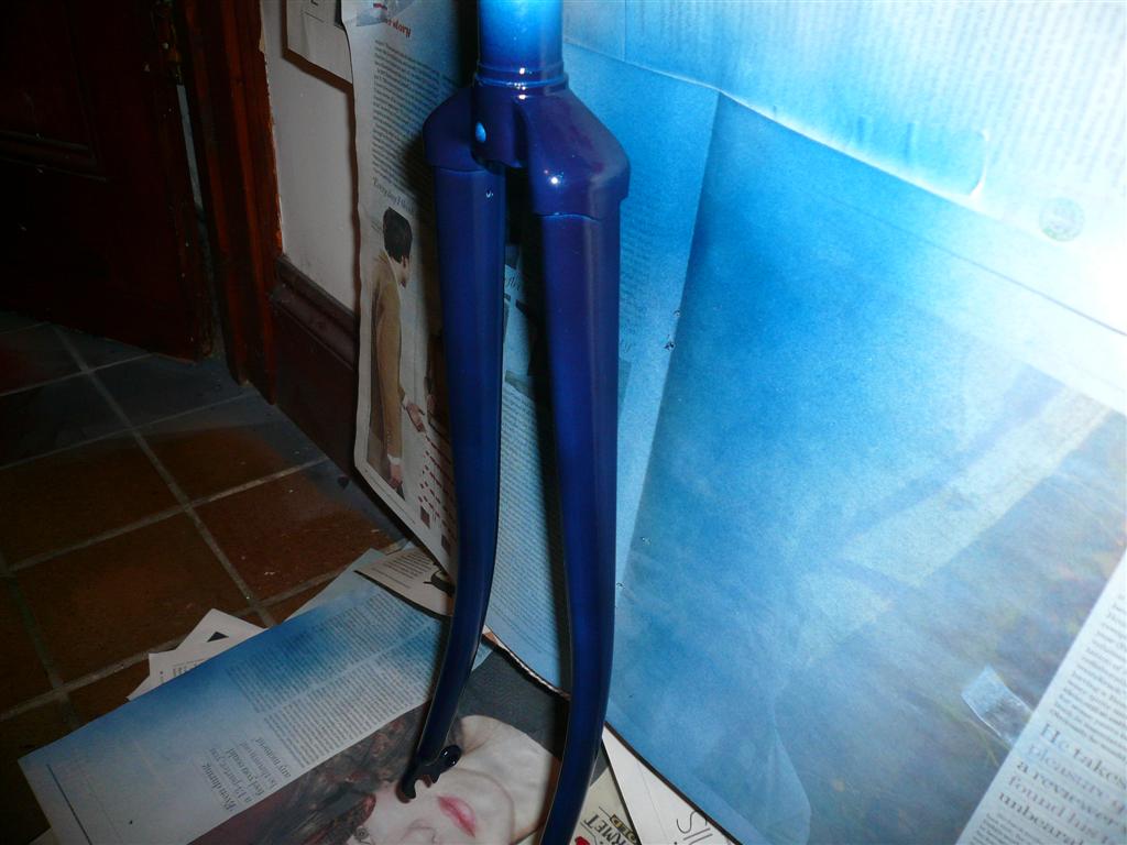

3/4 coats dark blue pearl, wet and dried inbetween each. Camera seems to have an amazing ability to pick up perfections because they look pristine in reality :P
Going to wait 24hrs now, sand them down again and give them some laquer which should hopefully bring out the pearliness.

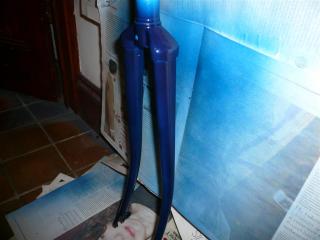

3/4 coats dark blue pearl, wet and dried inbetween each. Camera seems to have an amazing ability to pick up perfections because they look pristine in reality <img src="http://www.trials-forum.co.uk/forum/public/style_emoticons/<#EMO_DIR#>/tongue.gif" style="vertical-align:middle" emoid=":P" border="0" alt="tongue.gif" />
