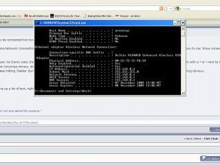

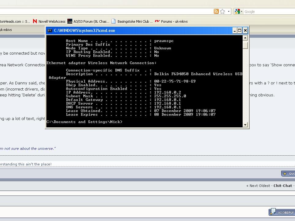

Prawny Baby Posted December 7, 2009 Author Report Share Posted December 7, 2009 Right, I've checked the boot menu stuff, and under integrated peripherals, I found the following:then I did the IP config jobby, and got this:Any ideas greatly welcomed! Quote Link to comment Share on other sites More sharing options...
Danny Posted December 7, 2009 Report Share Posted December 7, 2009 Scroll up a bit on that command window Quote Link to comment Share on other sites More sharing options...
Prawny Baby Posted December 7, 2009 Author Report Share Posted December 7, 2009 it just says windows IP configuration danny, that's all I don't get it! I've plugged my netbook in via the same cable and it works instantly. there's something gay about my PC Quote Link to comment Share on other sites More sharing options...
Tomm Posted December 7, 2009 Report Share Posted December 7, 2009 From the Ipconfig it doesn't look as though the ethernet onboard it installed properly. Click on Start, then right click My Network Places, click properties. There should be icons for Local Area Network, Firewire etc. Printscreen what is there. Is there anything that says "Disabled" under it? If so you should be able to enable it by right-clicking.If there is only the wifi there, then try right clicking my computer / properties /hardware tab / device manager. Is there anything with a red cross or an exclamation mark? Particularly under the network adapters section (but maybe also in the other devices section). Quote Link to comment Share on other sites More sharing options...
Prawny Baby Posted December 7, 2009 Author Report Share Posted December 7, 2009 Network places:What's odd is that it's currently saying connected, but there's no cable in it at all.....Device manager:No idea what the uninstalled things there are, but I don't think they're networking related. Quote Link to comment Share on other sites More sharing options...
anzo Posted December 7, 2009 Report Share Posted December 7, 2009 (edited) Looks to me like the drivers aren't installed for the onboard network card (intergrated with the motherboard I assume?)My reason for this is that although you're not connected via the ethernet (even with a network error) it'll still detail the LAN in the ipconfig /all report, secondly the LAN isn't showing in the network connections under the control panel - you should also have 'Ethernet Controller' under the Device Manager.1. Check the port at the back of the computer to ensure the greenlight is showing when the ethernet cable is plugged in, this will rule out a broken port.2. I'd select the LAN chipset to 'Enabled' within the BIOS (if it allows) and try that.3. Install the missing drivers - let me know the make and model of your PC, or the make and model of your motherboard if it was custom built.4. If none of that works, I'd install a network card to avoid using the onboard one - These are about 10 quid or so from a PC shop (don't go to PC world), but I have a dozen of them spare if you want one of those? Edited December 7, 2009 by anzo Quote Link to comment Share on other sites More sharing options...
