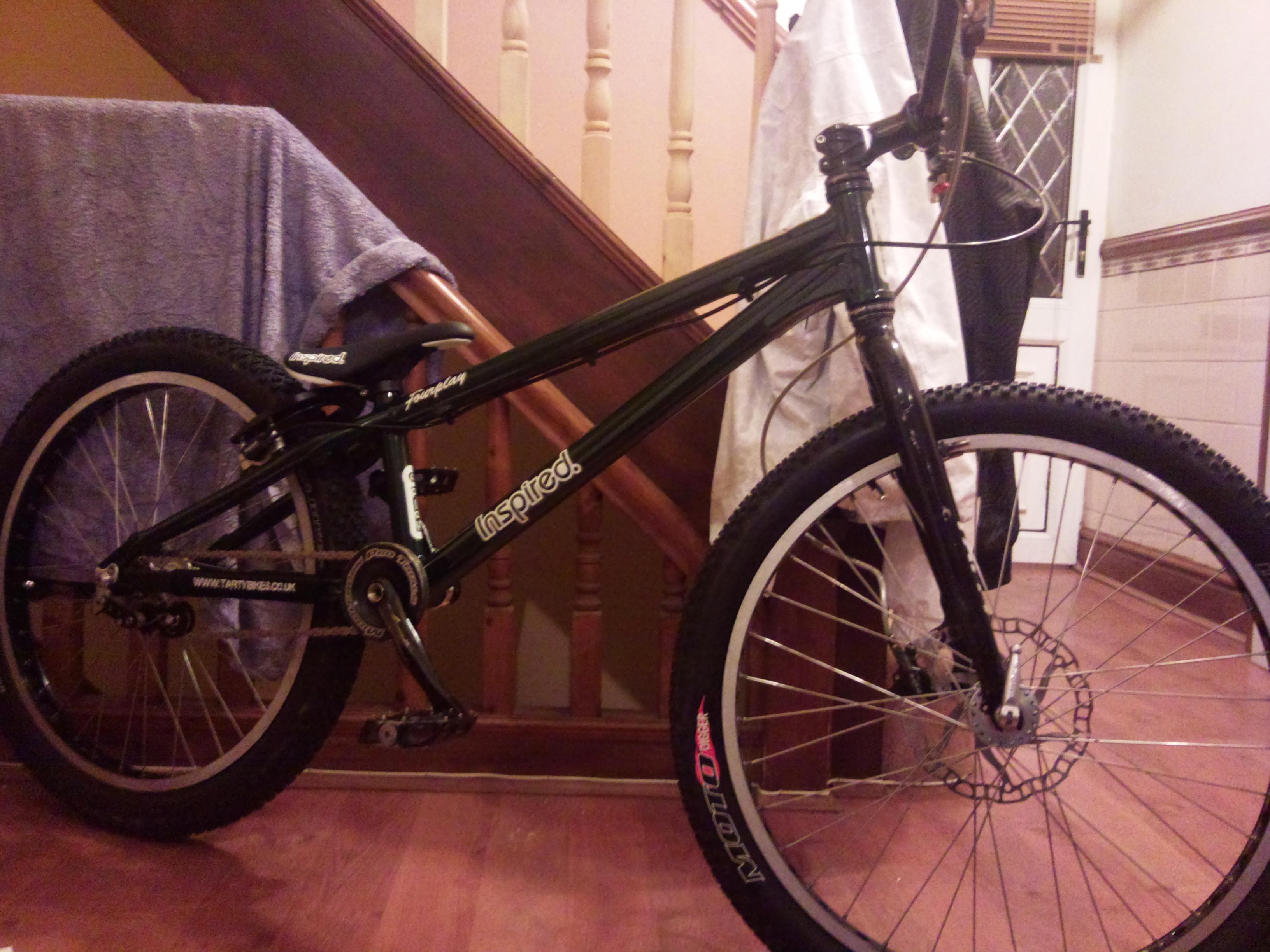

DaiTrials Posted November 14, 2009 Report Share Posted November 14, 2009 (edited) Hey all, finished this build today and i'm very happy with how it looks. It hasn't been out on a ride because the rains real bad here, hopefully tomorrow. Indoor at skate extreme if its hammering down again at very least.Here's a run down of the spec...Frame: Inspired FourplayFork: Fatty RRear Wheel: Onza Ronnie on Hope pro 2 trialsFront Wheel: Onza Reggie on HopeTyres: DMR Moto DiggerRear Brake: HS33 (TNN metal pads)Booster: Tensile 4-boltFront brake: Hope mono trials (trials pads +20 adapter and rockman 180 rotor)BB: Echo externalCrankset: Middleburn Pro TrialsFront Cog: Middleburn cd 20TPedals: DMR V12 MagnesiumChain: Trialtech LiteRear Drive: DMR single speed 16TTensioner: RohloffSeat/Post/Clamp: Inspired Headset: Hope with head-doctorStem: Hope CNC (90mm +10)Bars: Azonic double wall (1.5" rise)Grips: EchoOther Finishing Kit: Carbon stem stacker, DT double butted spokes, Tarty Chain guard, Maxis DH ® and welterweight (F) tubes, silver valve caps Edited November 14, 2009 by DaiTrials Quote Link to comment Share on other sites More sharing options...

Luke Rainbird Posted November 15, 2009 Report Share Posted November 15, 2009 Alright chill out, the pictures a million times better than half the crap posted in this subforum.Bike looks tidy dude, other than the bar/stem setup, how are you liking it compared to the 24uk? Quote Link to comment Share on other sites More sharing options...
DaiTrials Posted November 16, 2009 Author Report Share Posted November 16, 2009 yeah man, gd call. bar stem setup is bad. I got no room for stem stackers on the steerer so im going change the 90mm 10 degree stem for a system Ex 35 degree 100mm stem, and that should give me about 40mm extra height, at only 6mm shorter. the bars are supposed to be 2.5" rise so im not changing them, but if it still feels too low, i'll buy some black markets! I'm sure 40mm of height will be enough. just hope the 35 angle doesnt make it feel odd to spin and stuff... vid coming soon...Dave Quote Link to comment Share on other sites More sharing options...
