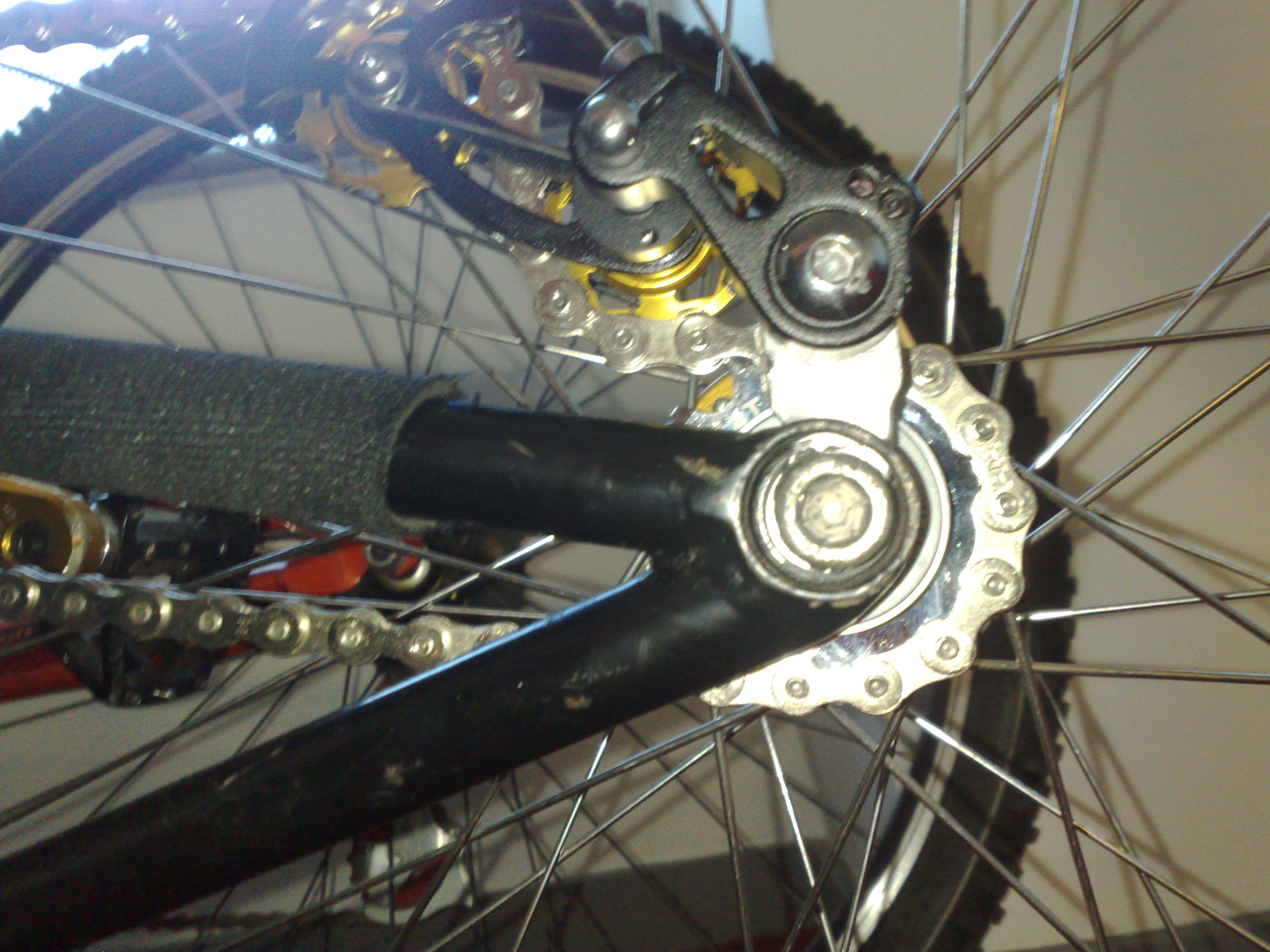

Chris (Khoie) Ellison Posted November 5, 2009 Report Share Posted November 5, 2009 Anyone whos rode with me knows im having a stupidly annoying problem with my chain skipping (ridding up on the rear cog)I originally ran 16-12 with a tensile tensioner (the pretty one with gold jockey wheels! )Thought it may be due to chain wrap, which everyone agreed, even when asking at tartybikes.....BUT...new 18-14 and new chain, and its still skipping. Tensioners inline and tensioned fine?What could be causing it??? its a hand made frame and hanger, so could this affect it?? Has worked fine previously. Any inputs better than me smashing my shins and knee for the 100th time! Cheers. Quote Link to comment Share on other sites More sharing options...

Chris (Khoie) Ellison Posted November 7, 2009 Author Report Share Posted November 7, 2009 (edited) The cogs n chain are all brand new, and correct pitch. I ordered them at same time so Tartybikes Advised best chain to get for my set up.The wrap around is pretty much as much as you can get, ill put a pic up in a second. Hava gander see what you think.Cheers for help so far though! Edited November 7, 2009 by Chris (Khoie) Ellison Quote Link to comment Share on other sites More sharing options...
Chris (Khoie) Ellison Posted November 8, 2009 Author Report Share Posted November 8, 2009 Bump. Pic added, Any ideas anyone??Cheers Quote Link to comment Share on other sites More sharing options...
monkeyseemonkeydo Posted November 8, 2009 Report Share Posted November 8, 2009 How old's the tensioner? Are the teeth of the jockey wheels a bit deformed? Other than that you might just need to tweak the alignment of the tensioner. Even if it's sitting perfectly at rest it may not be when you put a load of torque through the system. Quote Link to comment Share on other sites More sharing options...
Chris (Khoie) Ellison Posted November 8, 2009 Author Report Share Posted November 8, 2009 Tensioners brand new as well... Good thinking though I'll hava gander at that see how much plays in it.Cheers Quote Link to comment Share on other sites More sharing options...

Chris (Khoie) Ellison Posted November 10, 2009 Author Report Share Posted November 10, 2009 Its a hope pro 2, its pretty much new? So i doubt it'd be that.... The only thing i can think is if the jockey wheel is too close to the rear cog? Would that affect it? Quote Link to comment Share on other sites More sharing options...
