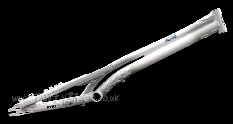

Joe@Onza Posted November 4, 2009 Author Report Share Posted November 4, 2009 (edited) The Ice for example has been a huge success due to its geo. A poll a few weeks ago placed it as the nicest frame to ride etc. I would say that was down to it being so easy to flick up and stay on the back wheel. Edited November 4, 2009 by Joe@Onza Quote Link to comment Share on other sites More sharing options...
Mark W Posted November 4, 2009 Report Share Posted November 4, 2009 I've actually got one sitting here next to me, but I kinda prefer the mid-length chainstays just 'cos once you go below 355mm, it feels like you can't preload as much for gaps and ups 'cos the stays are so short there's nothing to really 'push' against, so to speak. It's quite a nice bike though, and the newer dropouts should help silence the doubters Quote Link to comment Share on other sites More sharing options...

pogo Posted November 4, 2009 Report Share Posted November 4, 2009 The Ice for example has been a huge success due to its geo. A poll a few weeks ago placed it as the nicest frame to ride etc. I would say that was down to it being so easy to flick up and stay on the back wheel.Has the cracking issue been resolved on those yet? Quote Link to comment Share on other sites More sharing options...

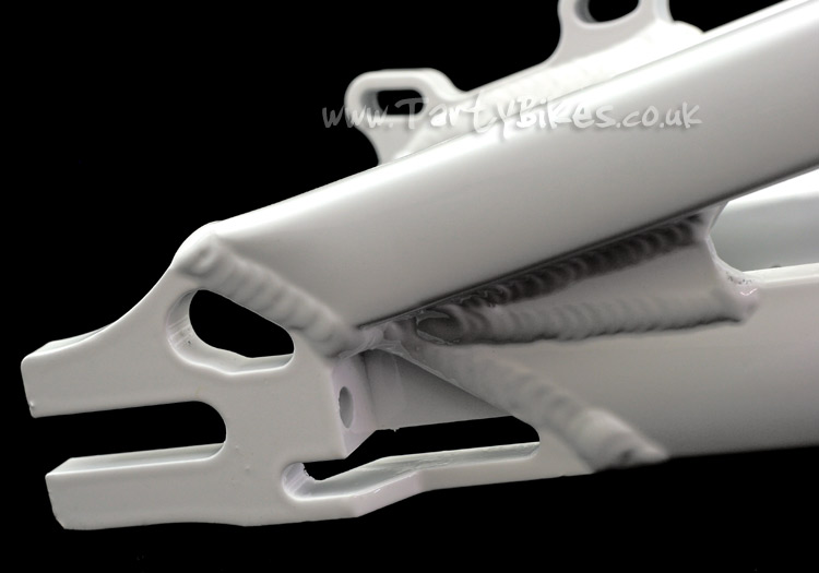

Mark W Posted November 4, 2009 Report Share Posted November 4, 2009 The cracking issue of less than 1% of the frames sold?In any case, the newer frames have upgraded dropouts to put people's minds at ease: Quote Link to comment Share on other sites More sharing options...
