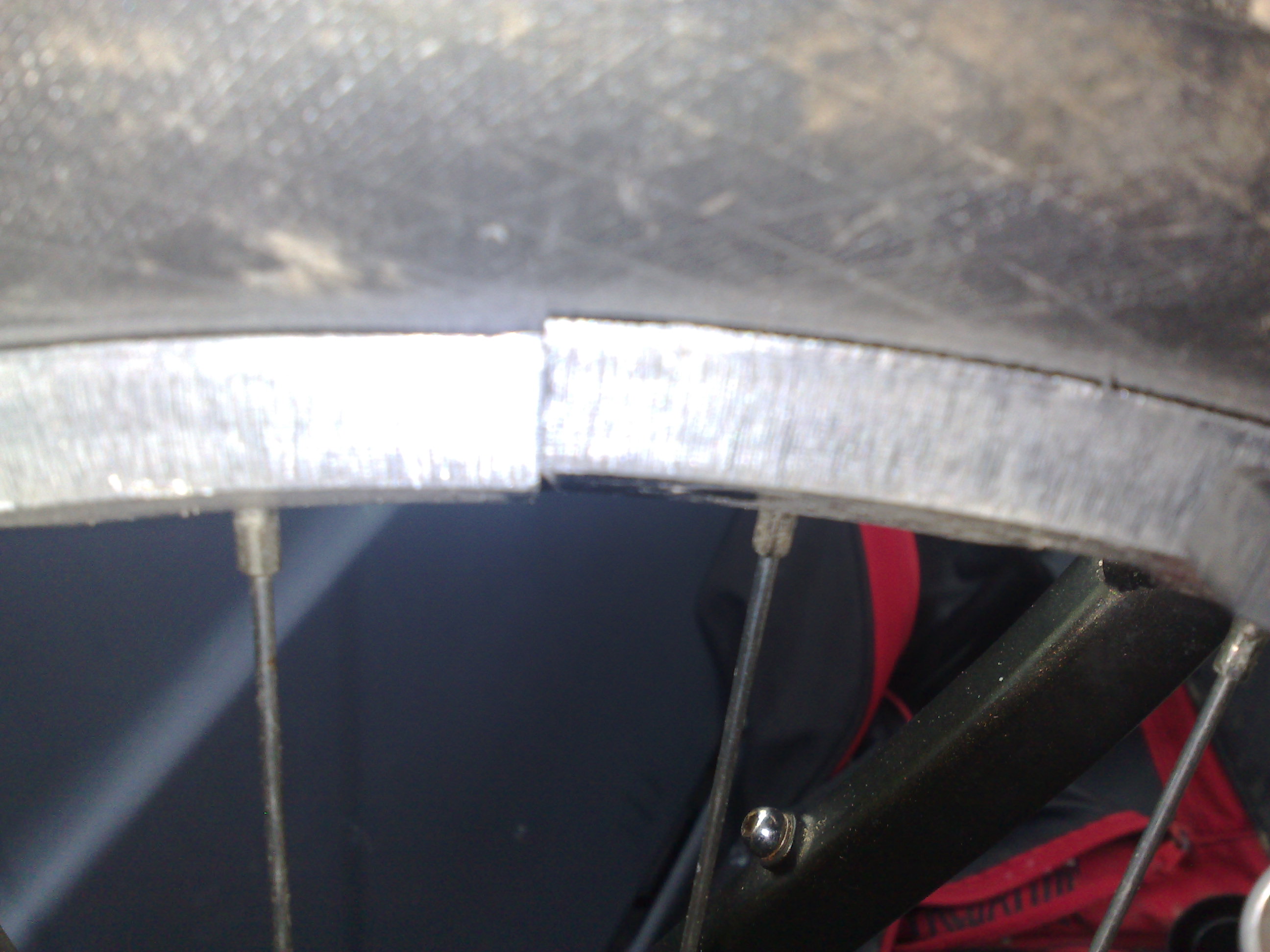

I have the echo TR rear rim, great grind from tarty but, the rim it self isn't great for novices like myself. 1st street ride with not a stupid low psi and flat spotted the rim. Differcult to self beat back into shape. Also on the rim join it seems to be coming apart not a gap but up and down a few mm.
What psi did you run and how much you weigh lbs/kgs?
