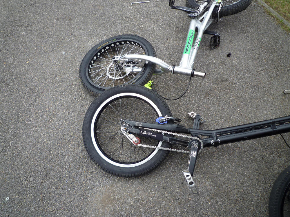

BigAl Posted October 29, 2009 Report Share Posted October 29, 2009 I modified a dmr tensioner to fit my gu.Worked really well. Quote Link to comment Share on other sites More sharing options...
Mark W Posted October 29, 2009 Report Share Posted October 29, 2009 Echo TR snail cams are a joy to use. I just put some on my bike after running some more heavily notched cams, and these win. Got micro grooves on them so you've got a lot more adjustability than most notched cams, but better holding power than smooths. They're rad! Quote Link to comment Share on other sites More sharing options...
nickdonboy Posted October 29, 2009 Report Share Posted October 29, 2009 that's ace, hard to do? Quote Link to comment Share on other sites More sharing options...
BigAl Posted October 29, 2009 Report Share Posted October 29, 2009 that's ace, hard to do?Little bit of grinding involved, then just bend the tensioner so its a straight bit of metal. Quote Link to comment Share on other sites More sharing options...
Mark W Posted October 29, 2009 Report Share Posted October 29, 2009 That looks a bit sketchy in terms of chain wrap on your rear sprocket - looks like there's only about a third of your sprocket is engaging with your chain, which isn't great for your chain and/or sprocket... Quote Link to comment Share on other sites More sharing options...
Brisa Posted October 29, 2009 Report Share Posted October 29, 2009 Not to mention the over complication... Quote Link to comment Share on other sites More sharing options...
BigAl Posted October 29, 2009 Report Share Posted October 29, 2009 Its fine, never skipped on the sprocket, it was mint.Chain wrap was alot better than it looks in the pic Quote Link to comment Share on other sites More sharing options...
Mark W Posted October 29, 2009 Report Share Posted October 29, 2009 Yeah, wasn't thinking necessarily in terms of skipping alone, but if you've got the chain only engaging with, say, 4 teeth compared to a normal chain engaging with 6, each tooth is taking a lot more strain than it would do ordinarily, meaning more stress on your chain. It may not be a problem, but I'm not sure I'd wanna run it. Not to mention I'm a terrible person and I sidehop to the right, meaning that I'd probably dominate anything below chainstay level reasonably quickly Quote Link to comment Share on other sites More sharing options...
BigAl Posted October 29, 2009 Report Share Posted October 29, 2009 (edited) Learn to go the correct way and stop mocking my stuff then Sir. Haha. Edited October 29, 2009 by BigAl Quote Link to comment Share on other sites More sharing options...
