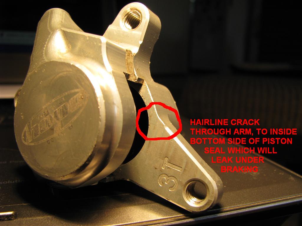

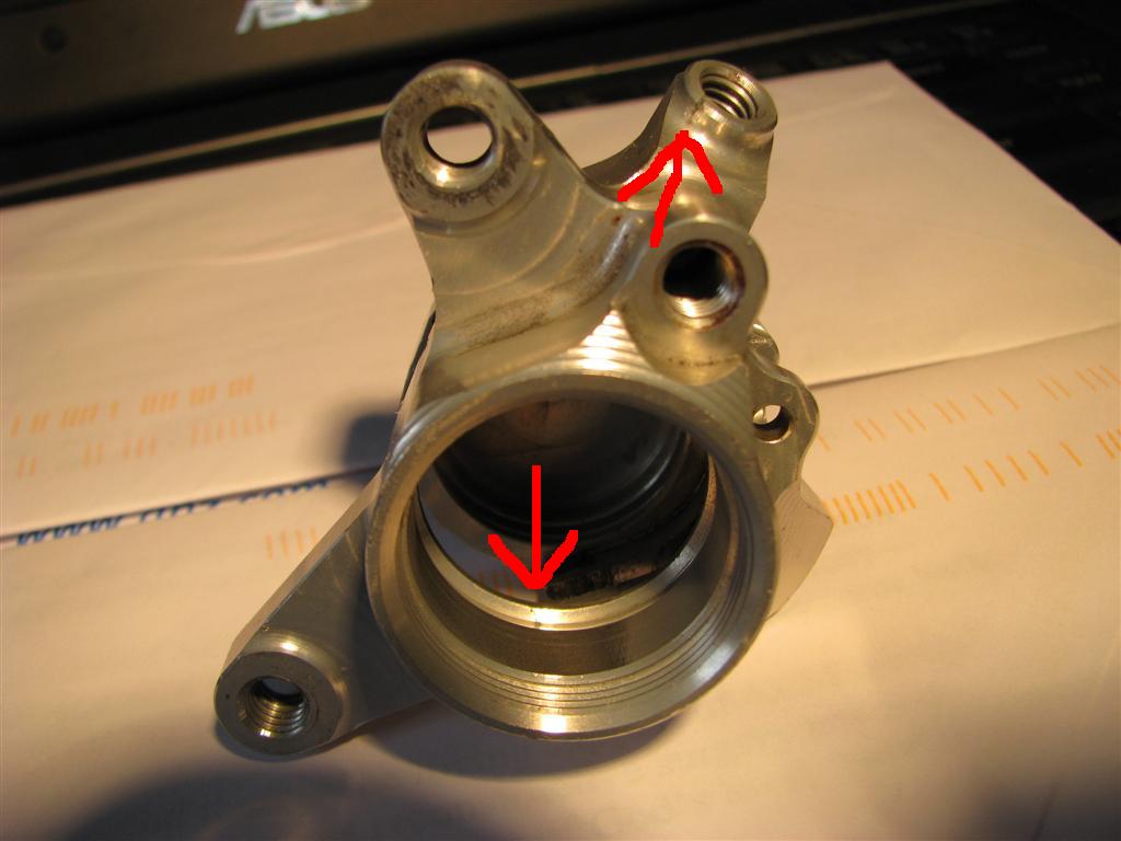

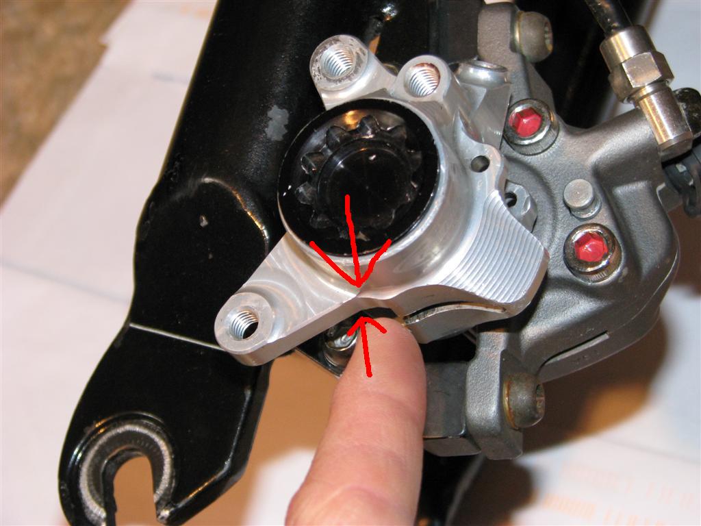

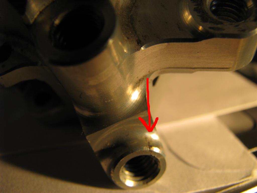

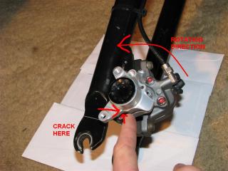

† CETFLY † Posted October 28, 2009 Report Share Posted October 28, 2009 (edited) If anyone has had problems with their hope mono trial suddenly failing I'd like to know because this is probably the reason why.Here are some pics of where its cracked.Its cracked, from the inside where it loads-up under braking (on the casing), all the way through to the inside of the outer piston seal (bore cap piston seal). Ive just had a specialist in crack repairs for carbon bike frames etc help me rebuild it and he saw it and took some pics of it with his mega macro camera.The other crack he noticed was the bleed screw. Its been overtightened and cracked the casing.Its meant to be 7075 alloy, but dont go over tightening them like this has been!!This is very heart breaking as its completely useless to me now after buying it, and then the full rebuild kit, plus red anodized bore cap, resevoir cap, dot fluid etc. Its all come up to a LOT of money and also when Ive purchased all the parts from tarys too.I need to know if James Quigley (who sold me the brake, but wouldnt have known about the crack) was the first owner and if he's able to contact hope to see if they have had this happen before and if they'll give you a replacement body under some form of warranty.This whole build has been much the same with things going wrong with getting the bike with heaps of extra costs that werent allowed for, hub problems requiring swapping, new rim and spokes needed, the list goes on. This is another financial kick in the ballsThe crack goes from the outside mounting bolt to the inside of the piston seal, thus rendering it useless to me.Im wondering if this is a total design flaw and if anyone else has had this problemWes Edited October 28, 2009 by † CETFLY † Quote Link to comment Share on other sites More sharing options...

† CETFLY † Posted October 29, 2009 Author Report Share Posted October 29, 2009 Who is James Quigley?I've sent you an email buddy, hopefully get Hope to Sort it, like Ben said Hope are pretty good at customer service.just like to point out I couldn't have know about the crack and am not a dodgey seller. I am going to help get this sorted, please dont hate me.Hahaha nah mate, not angry at you or anything. Just annoyed at the situation im in. You couldnt have possibly known. It was only when rebuilding it with new seals that the specialist noticed it and took some super macro shots of it to show it.By no way are you a dodgy seller mate, not at all. You were great with getting this to me and I appreciate all the help with the current situation.This thread was more of an info page for people who've had issues with their own Hope Mono's or bad experiences as it shows the design flaws with Hopes body and explains why they may have had problems. With this type of crack they can lose power significantly, bleed out past the piston seal and potentially onto the pads, again, reducing power greatly.Got some more pics here to make it clearer to everyone exactly where they crack. This kind of thing shouldnt happen. Hope need reinforcing at this point. The curves need to be much smoother rather than sharp (where the cnc machine has been)Wes Quote Link to comment Share on other sites More sharing options...
AdamR28 Posted October 29, 2009 Report Share Posted October 29, 2009 Hope need reinforcing at this point.Not sure they do really, I have NEVER seen this happen before so it's clearly just one caliper with a tiny imperfection, which can happen to any product. Hope will sort you out. Quote Link to comment Share on other sites More sharing options...
† CETFLY † Posted October 29, 2009 Author Report Share Posted October 29, 2009 Not sure they do really, I have NEVER seen this happen before so it's clearly just one caliper with a tiny imperfection, which can happen to any product. Hope will sort you out.Hey mateI wouldnt have either but this is what the specialist said.If anything, theres no need for that part of the body to be machined away. It should be left a bit thicker and with a smoother surface. Its the fact that its a sharp "corner" (in a way) taking the load whereas a smooth sweeping radius will be much stronger.James is going through Hope to see what he can do to help me out. Top bloke. Cant recommend him high enough as a seller and nice guy, even before this happened Thanks James Quote Link to comment Share on other sites More sharing options...

AdamR28 Posted October 29, 2009 Report Share Posted October 29, 2009 Hey mateI wouldnt have either but this is what the specialist said. *general engineering drivel*'Engineer' or bike parts specialist?As I said, a small defect meaning a sharp corner was still present, so it's a one-off... It's clearly not an issue as I have not even heard of it happening before. Good that James is getting you sorted Quote Link to comment Share on other sites More sharing options...
† CETFLY † Posted October 29, 2009 Author Report Share Posted October 29, 2009 'Engineer' or bike parts specialist?As I said, a small defect meaning a sharp corner was still present, so it's a one-off... It's clearly not an issue as I have not even heard of it happening before. Good that James is getting you sorted Engineer without the bit of paper He does testing into where carbon fibre breaks on bikes for court cases using special resin and UV light with macro zoom camera etc etc. He repairs carbon fibre frames and thats his field speciality. He does many reports for serious court cases in terms of analysing peoples bikes in accidents hit by cars. One kid was left a vegetable, the other woman riding her carbon frame bike was left a paraplegic. He analyses steel bikes, alloy, carbon, the works. He showed me a few cases he was working on, it gets extremely technical. He has to work out the speed, direction, impact force and angle etc all variables from the evidence of whats left of a bike. He tests stress fractures, breaks, the lot.If in court the other legal team go to question his credentials, his own engineers (from the other company he's working with) back him up as they also test his evidence.Trust me, he's far more than a regular bike mechanic. He has extensive physics and chemistry backgrounds. Has designed his own resin which theyre testing as a new form of shock absorber for the car industry, developed his own (INSANELY BRIGHT) LED light to replace normal lights, but at 1/3 the amperage consumption and having a thickness of only 7mm (seen it myself) etc.Hes a very smart guy. Really interesting to chat to actually. A lot to learn from a person like him. Quote Link to comment Share on other sites More sharing options...
