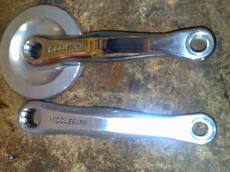

† CETFLY † Posted October 21, 2009 Author Report Share Posted October 21, 2009 I polished and cleaned mine up with 1200 1600 1800 and 2400 grit wet and dry with lots of soapy waterand then autosol'd the hell out of them with elbow grease, a buffing wheel would make life a lot lot easier!Wow youre kidding! That wouldve taken you ages! Still extremely hard to get it as shiney as what a buffing wheel can. Got any pics?I'd probably have to spend an hour or so on both arms on the buffing wheel to get it to mirror finish Quote Link to comment Share on other sites More sharing options...

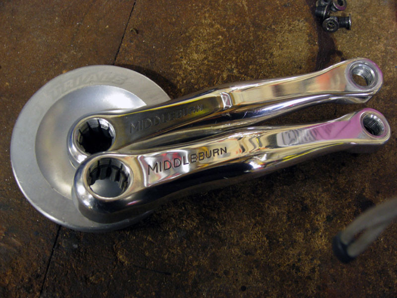

craigjames Posted October 21, 2009 Report Share Posted October 21, 2009 Pics are a lil old, please bare in mind i took these back from manked up cranks and could have taken a lot more time with them and got them a million times better.When i was finished with them:Comparison between the 2/3's done drive side and the original non drive.Sorry about the quality. Quote Link to comment Share on other sites More sharing options...
† CETFLY † Posted October 21, 2009 Author Report Share Posted October 21, 2009 Pics are a lil old, please bare in mind i took these back from manked up cranks and could have taken a lot more time with them and got them a million times better.When i was finished with them:Comparison between the 2/3's done drive side and the original non drive.Sorry about the quality.Mate, they look fantastic! Thats about the quality Id get mine to on the bufferYours look amazing with how youve done them. You mustve spent many MANY hours doing all that Quote Link to comment Share on other sites More sharing options...
craigjames Posted October 21, 2009 Report Share Posted October 21, 2009 Yeah i think 3-4 hours in total, sanding down the scratches and gouges and then working up to 1200 grit, which looking through the photos is all i had and then buffing with a nice soft cloth and autosol. The more time you spend sanding them down and working up the grit grades gradually with the wet and dry the easier the polishing is. I've got another set of black cranks I'm going to do soon. Going to town on them though Quote Link to comment Share on other sites More sharing options...
† CETFLY † Posted October 21, 2009 Author Report Share Posted October 21, 2009 Yeah i think 3-4 hours in total, sanding down the scratches and gouges and then working up to 1200 grit, which looking through the photos is all i had and then buffing with a nice soft cloth and autosol. The more time you spend sanding them down and working up the grit grades gradually with the wet and dry the easier the polishing is. I've got another set of black cranks I'm going to do soon. Going to town on them though Yeah, I agree completely. Going through the grades of sanding will remove any damage and the top layer. Just very time consuming. Mine are fairly new looking and wouldnt take overly long to do on a buffer and all i have to do i apply pressure and apply the block of polish occasionally to the spinning wheel Not sure if I'll do it or not yet though. Will see. I will try to put up some pics tomorrow of the bike in its current state.Dropped the rims off to a rim builder.....damn.....am i GLAD im getting him to build these rims!Far out he KNOWS his stuff! Been building rims for 30+years. I completely cocked up the front rim which *seemed* easy enough but he's going to do a stronger form of lacing and also better for the rear.He said the rear Pro 2Trials hubs are VERY well designed, very well balanced and very strong. He said pretty much the opposite for the front Hope Pro 2 hubHe said it was totally out of balance (with the center point being offset too much when the hub couldve and shouldve been designed with more thought). He says it should have been extended out further on the non disc side to allow the hub to be more central within the rim and not having the disc side taking the majority of the loading.He's ordering in a 36h rim for the 36h Trials hub. Should be there and all finished within a week Damn it, another 7days plus i think its going to be raining this time next week... Quote Link to comment Share on other sites More sharing options...
