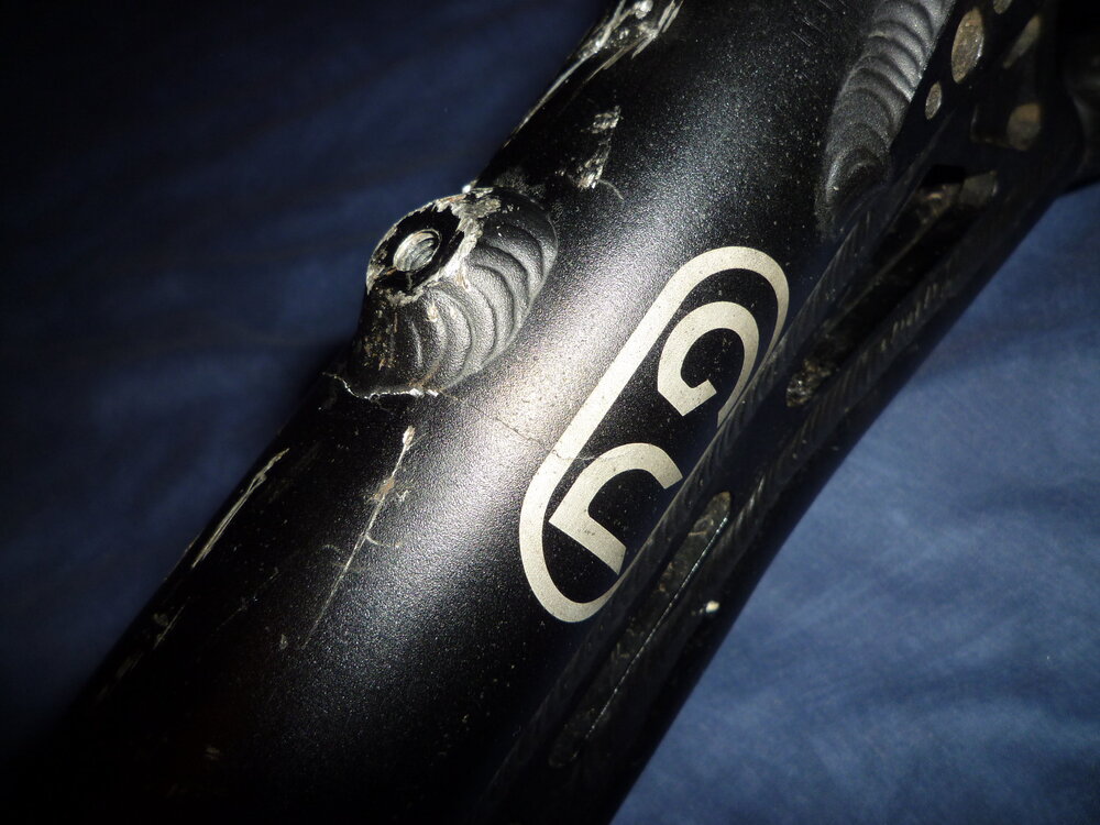

Luke_zoo Posted October 17, 2009 Report Share Posted October 17, 2009 Hey all, Here is Patricks gu typhoon crack and drilled out must of saved around 200grams I think..He is getting it welded up soon.What do you guys think?Cheers, Luke Quote Link to comment Share on other sites More sharing options...

Dale-Hill Posted October 17, 2009 Report Share Posted October 17, 2009 Oh and dear.+1 No wounder it cracked! Quote Link to comment Share on other sites More sharing options...

Luke_zoo Posted October 17, 2009 Author Report Share Posted October 17, 2009 It cracked before he did the modding. Quote Link to comment Share on other sites More sharing options...
weirdoku Posted October 17, 2009 Report Share Posted October 17, 2009 did he use a bashplate? they spread the frame, cracking it. Quote Link to comment Share on other sites More sharing options...
Luke_zoo Posted October 17, 2009 Author Report Share Posted October 17, 2009 did he use a bashplate? they spread the frame, cracking it.Yeah it had a bash plate. Quote Link to comment Share on other sites More sharing options...

am-i-bothered Posted October 18, 2009 Report Share Posted October 18, 2009 Yeah thats my frame. Drilled it out once I saw crack. Saved my self over 250grams. Once its welded it's going to be epic. Quote Link to comment Share on other sites More sharing options...
Luke_zoo Posted October 18, 2009 Author Report Share Posted October 18, 2009 Yeah thats my frame. Drilled it out once I saw crack. Saved my self over 250grams. Once its welded it's going to be epic.How you going to weld round it? Quote Link to comment Share on other sites More sharing options...
Paperclip Posted October 18, 2009 Report Share Posted October 18, 2009 just drill the crack out then theyll be no crack in your frame so itll be all fixed :| I think its pretty cool how its been drilled but kinda makes it pointless buying a gu 08 and drilling it out like that when you could just buy a lighter frame in the firstplace :/ shame about the crack. Quote Link to comment Share on other sites More sharing options...
am-i-bothered Posted October 18, 2009 Report Share Posted October 18, 2009 just drill the crack out then theyll be no crack in your frame so itll be all fixed :| I think its pretty cool how its been drilled but kinda makes it pointless buying a gu 08 and drilling it out like that when you could just buy a lighter frame in the firstplace :/ shame about the crack.It cracked before I started modding it so I thought id experiment with welding and drilling it before I hang it on the wall. Quote Link to comment Share on other sites More sharing options...
craigjames Posted October 19, 2009 Report Share Posted October 19, 2009 you do realise welding a 6000 series alu frame reduces its strength in thr weld area by about 50-80% if you don't post weld heat treat it. That and the drilling should make it last the whole of about 2 weeks if you're lucky. For the love of god wear a helmet. Quote Link to comment Share on other sites More sharing options...
