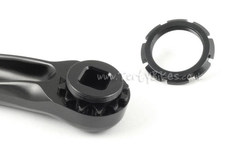

BringThatShtIn Posted September 17, 2009 Author Report Share Posted September 17, 2009 This may sound sort of noobish, but is the freewheel an alternative to a chainring? Is that what you're saying?So I'd just need a freewheel, cranks that fit it and a bashring (and BB)?Thanks for the info so far Quote Link to comment Share on other sites More sharing options...

forteh Posted September 17, 2009 Report Share Posted September 17, 2009 (edited) This may sound sort of noobish, but is the freewheel an alternative to a chainring? Is that what you're saying?So I'd just need a freewheel, cranks that fit it and a bashring (and BB)?Thanks for the info so far Freewheels can be mounted at the back (using a screw on fixed hub) or more commonly on the front (using screw on cranks - 90% of trials cranks are screw on). If you have a rear freehub (like a hope proII or a chris king) then you need a fixed front sprocket, this would just be a screw on sprocket (unless you have middleburns). If you have a fixed rear hub then you need front freewheel.The main advantage of the smaller gear ratio (18:15) is that you can save alot of weight by using smaller sprockets and shorter chain, however unless you have the spare cash to spunk on a new set of cranks then its not really worth it.Im assuming you already have a freehub on the back, your cheapest option would be to run 22:18, next would be to get some screw on cranks with a screw on sprocket. To go front freewheel you would need new cranks, rear hub+sprocket and a freewheel. Edited September 17, 2009 by forteh Quote Link to comment Share on other sites More sharing options...
