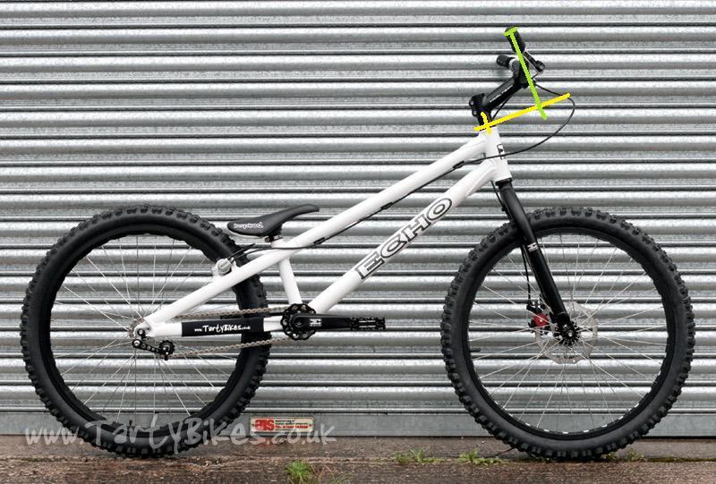

This is a fairly random request, but could anyone with a 24" bike give me these two measurements?
Hopefully it should be reasonably straightforward from that, but just basically from the headtube/bars to where they intersect with each other.
