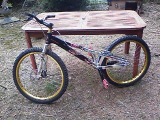

gale30jawa Posted August 30, 2009 Report Share Posted August 30, 2009 hear is a pic of my now dead t rex Quote Link to comment Share on other sites More sharing options...
Mr Bob Posted August 30, 2009 Report Share Posted August 30, 2009 looks cool, why dead? Quote Link to comment Share on other sites More sharing options...
gale30jawa Posted August 30, 2009 Author Report Share Posted August 30, 2009 looks cool, why dead?front cog rubbed throuh the frame behind the bash ring Quote Link to comment Share on other sites More sharing options...
stunt man t Posted September 1, 2009 Report Share Posted September 1, 2009 (edited) front cog rubbed throuh the frame behind the bash ring my mates did thatdesign fault??what frame you getting next?? Edited September 1, 2009 by stunt man t Quote Link to comment Share on other sites More sharing options...
gale30jawa Posted September 1, 2009 Author Report Share Posted September 1, 2009 my mates did thatdesign fault??what frame you getting next??yeah i think it mite be a design fault!!dont know whot frame to get next repairint that one for now i am skint!! Quote Link to comment Share on other sites More sharing options...
Ross McArthur Posted September 2, 2009 Report Share Posted September 2, 2009 yeah i think it mite be a design fault!!It may just be that you need a longer BB so the cog clears the frame. Most trials riders use a 127.5mm or 128mm BB. Quote Link to comment Share on other sites More sharing options...
Alex Dark Posted September 2, 2009 Report Share Posted September 2, 2009 It may just be that you need a longer BB so the cog clears the frame. Most trials riders use a 127.5mm or 128mm BB. i think it had to be that...or a VERY bent cog...anyway, you should hgave really remedied it before it went through just get it welded and get a few more months out of it...i would Quote Link to comment Share on other sites More sharing options...
gale30jawa Posted September 2, 2009 Author Report Share Posted September 2, 2009 i think it had to be that...or a VERY bent cog...anyway, you should hgave really remedied it before it went through just get it welded and get a few more months out of it...i woulddad is going to weld it for me and i will be back out on it soon Quote Link to comment Share on other sites More sharing options...

gale30jawa Posted September 7, 2009 Author Report Share Posted September 7, 2009 sincr found out the bottom bracket is too short for the fame thats why it rubbed Quote Link to comment Share on other sites More sharing options...
