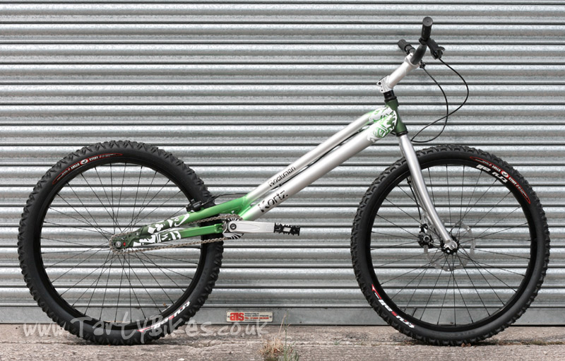

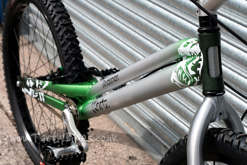

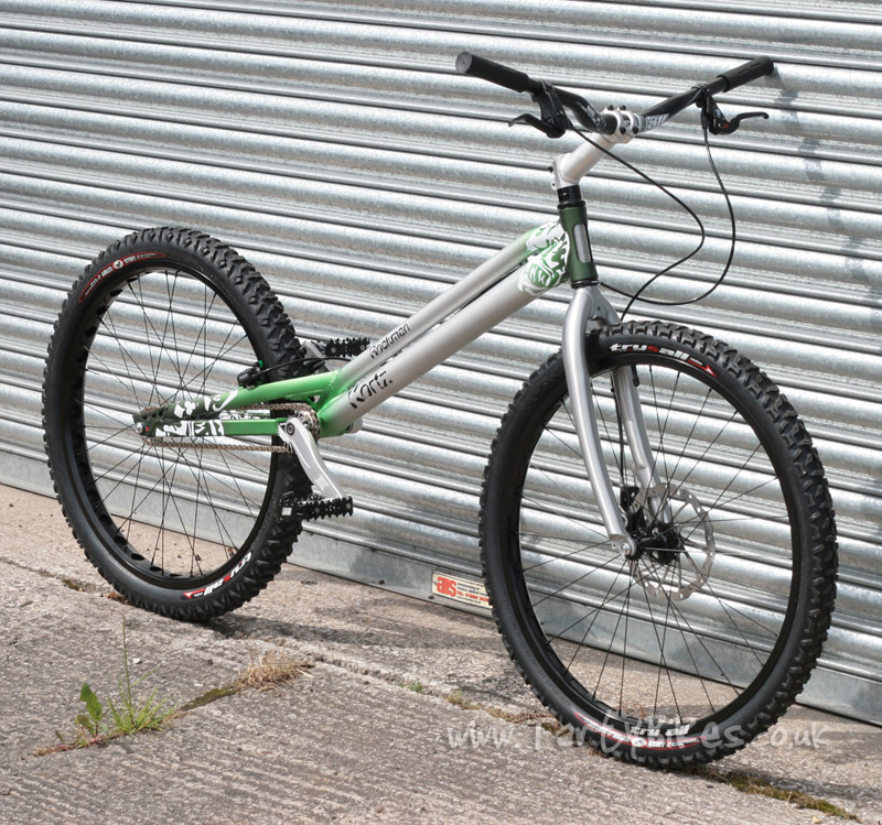

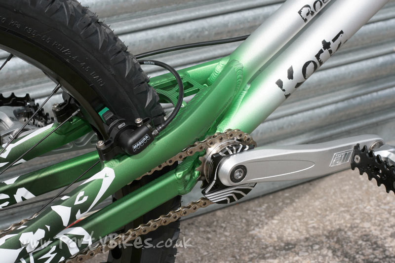

AdamR28 Posted July 30, 2009 Report Share Posted July 30, 2009 Built this on Friday but only just got chance to stick the pics up:Geo:Wheelbase: 1100mmChainstay Length: 380mmBB Rise: 60mmHead Angle: 70.5 degreesCentre of BB shell to top centre of head tube: 670mmWeight: 10.08kgCheersAdam Quote Link to comment Share on other sites More sharing options...
RossMcd Posted July 30, 2009 Report Share Posted July 30, 2009 Really Like that! Green really stands out against the black components Quote Link to comment Share on other sites More sharing options...
Dan Thornton Posted July 30, 2009 Report Share Posted July 30, 2009 Wow, that frame is so nicee. Really like them.Full build spec looks amazingg. Dan. Quote Link to comment Share on other sites More sharing options...
Joe Papasnap Maher Posted July 30, 2009 Report Share Posted July 30, 2009 Black stem and forks adam!! Silver doesnt do it for me! Quote Link to comment Share on other sites More sharing options...

AdamR28 Posted July 30, 2009 Author Report Share Posted July 30, 2009 A good point you've made there Adam, Plenty of frames at £300, so why should these be any different in price ? Its all the same shit just with different geo, weight and design.The frames aren't all the same though, there are huge differences. Just like with ANY product, the higher end stuff has much more put into it.Example:'Cheap' frame:- Plain gauge tubing with simple shapes (Echo lite)- Less CNC work (Echo Lite)- Made to lower tolerances (Da Bomb etc)- Standard sticker graphics (ZOO Pitbull)- Basic paint finish or just lacquered (Echo/ZOO/Adamant)Car analogy: BMW (cos this type of trials bike frame is MUCH better than a Halfords special/Kia)'Expensive' frame:- Butted or hydroformed tubing, extra bends, complex profiles (Hydroxx, Monty Kamel, Limey 3)- Lots of CNC work (Koxx XTP/Sky)- Made to higher standards, better welding, higher tolerances (Koxx)- Anodised finish or water transfers, even fade anodising like in the case of the Rockman! (Kortz, Slate)- Cost of supporting a huge world team with equipment, travel expenses etc... (Monty, Koxx)Car analogy: FerarriGet what I mean?Ads Quote Link to comment Share on other sites More sharing options...
