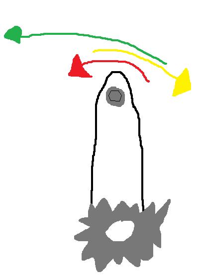

I need to get my pedal off my driveside crank, ive tried undoing it left/right and it wont budge. Does lefty loosy righty tighty apply lol? See my pic for details. Its an allen bolt by the way but I havent illustrated the pedal.
1.Red line is the way ive been trying
2.Yellow line I have also tryed with no hope
3.Green line shows the way the pedal would rotate? so if the bearings seized the pedal could undo whilst riding?
Edited by LukasMcNeal
Look at the crank as it would be on the bike. Turn the pedal towards the rear wheel. Clockwise.
Do that!
The way i remember when at work, if i put the pedal spanner on the pedal, pedal it backwards it tightens up, pedal forwards it loosens it. This works on driveside and non-driveside.
