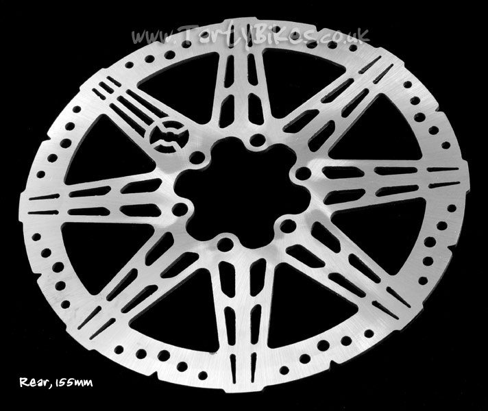

ogre Posted July 20, 2009 Report Share Posted July 20, 2009 a 180 or 200 version of the tryall rear 155mm for stocks wouldnt be bad. Quote Link to comment Share on other sites More sharing options...
Luke Rainbird Posted July 20, 2009 Report Share Posted July 20, 2009 Didn't those have an issue with cracking? Quote Link to comment Share on other sites More sharing options...
