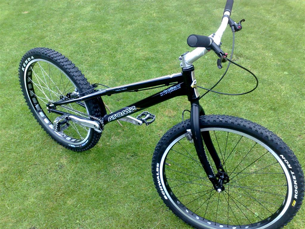

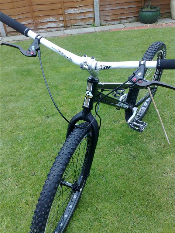

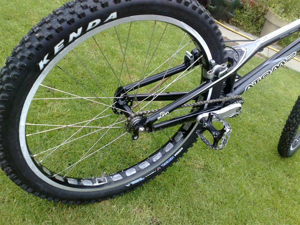

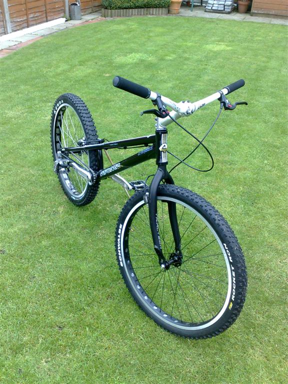

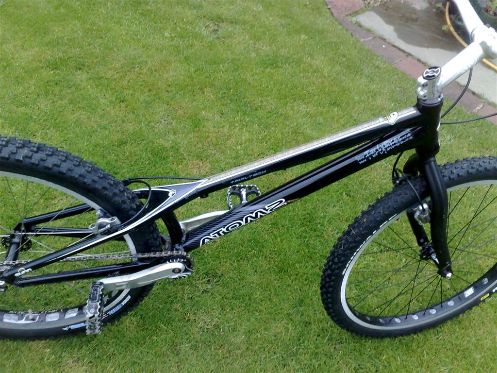

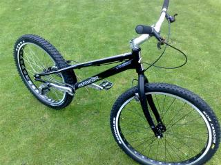

Well i've had my premier for 2months now, realy liking it, suits me well i think. finally destroyed my tryall rim from my Yaabaa thats lasted since october last year! So New rear rim and front wheel, along with grips and tyres :)
Spec as follows.
Atomz Premier
Trialtech for bolt forks
Dual magura with four finger blades and pimp red bolts :P Phat pads on rear, croco greens upfront
Fsa headset
Tryall BB
Tryall cranks and bash guard
Viz freewheel
Trialtech chain
Tryall 'H' disk hubs front and rear, On Tryall Holes rear rim, standard Tryall rim upfront
Kenda Nevegal 2.5 rear tyre, front Schwable Rocket Ron
Tryall stem and 09 Tryall rage bars
Trialtech grips
Weighs in at a smig over 9.3KG :)

Thats really nice, compared to the brown one, whats the geo?
The Quark will be avalible in three options:
Short : 1075, 380, + 40, 72°
Medium : 1085, 380, + 45, 72°
Long : 1095, 380, + 50, 72°.
The Premier is only avalible as:
Wheelbase: 1085mm
Chainstay Length: 380mm
BB Rise: 30mm
Head Angle: 71.5 degrees
