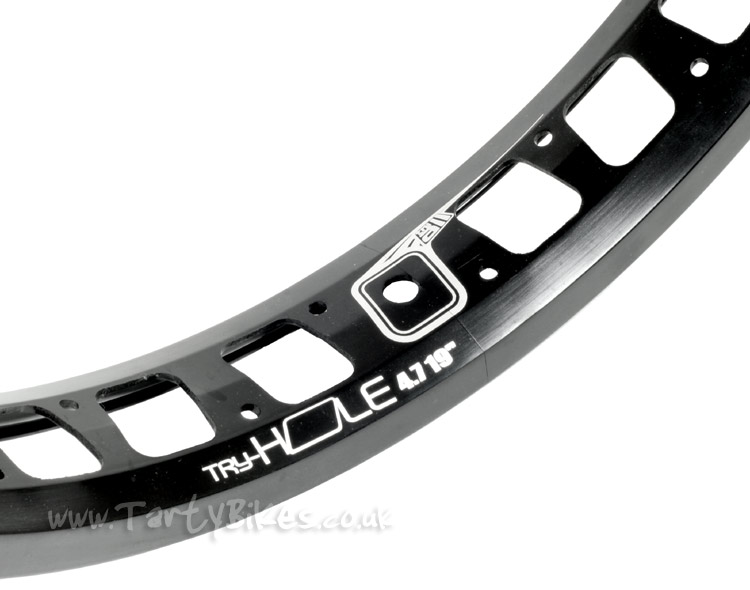

stunt man t Posted July 2, 2009 Report Share Posted July 2, 2009 right, im trying to build a try-all hole rimit has off-set spoke holes and when i lace up the wheel the spokes dont turn out like thishttp://www.tartybikes.co.uk/images/bikes20...oxx220bike6.jpgas you can see the spoke nearest to the left side of the rim goes to the left side of the hubbut when i lace mine up the spoke that goes to the right side of the rim goes to the left side of the hub p.s im build my wheels the same way as shown in the wikiany ideas??or are you as confused as me? Quote Link to comment Share on other sites More sharing options...
N.Wood Posted July 2, 2009 Report Share Posted July 2, 2009 Just do as you're doing bit flip the rim around 180 degrees? I dunno I can't really see how its a hard thing to do. Quote Link to comment Share on other sites More sharing options...
stunt man t Posted July 2, 2009 Author Report Share Posted July 2, 2009 Just do as you're doing bit flip the rim around 180 degrees? I dunno I can't really see how its a hard thing to do.the first spoke goes to the right hole of the valve hole, right?then you put it in the drive side of the hub and the spokes dont look like they do on that pic??they seem to cross more Quote Link to comment Share on other sites More sharing options...
Maladie Posted July 2, 2009 Report Share Posted July 2, 2009 the first spoke goes to the right hole of the valve hole, right?then you put it in the drive side of the hub and the spokes dont look like they do on that pic??they seem to cross moreMaybe because you are building it a different way?EG: The wheel shown in the picture could be built 4 cross, and you are trying to build yours 3 cross?[Not that I know the difference between either of those things ] Quote Link to comment Share on other sites More sharing options...
stunt man t Posted July 2, 2009 Author Report Share Posted July 2, 2009 (edited) Maybe because you are building it a different way?EG: The wheel shown in the picture could be built 4 cross, and you are trying to build yours 3 cross?[Not that I know the difference between either of those things ]i dont mean cross spokes more i ment if you look at theis picturehttp://www.tartybikes.co.uk/images/bikes20...oxx220bike6.jpgyou can see the spoke thats nearest to the left side of rim goes into left side of hubware as mine goes in to the right they cross.. Edited July 2, 2009 by stunt man t Quote Link to comment Share on other sites More sharing options...
N.Wood Posted July 2, 2009 Report Share Posted July 2, 2009 Like I said... Just undo what you've done, turn the rim around 180 and problem solved? Quote Link to comment Share on other sites More sharing options...
stunt man t Posted July 2, 2009 Author Report Share Posted July 2, 2009 (edited) Like I said... Just undo what you've done, turn the rim around 180 and problem solved?itll be the same though wudnt it?http://www.tartybikes.co.uk/images/rims/la...anew19black.jpgthe spoke hole will still be in the same placehttp://www.trials-forum.co.uk/wiki/Image:W..._westlake_7.jpg Edited July 2, 2009 by stunt man t Quote Link to comment Share on other sites More sharing options...
JonMack Posted July 2, 2009 Report Share Posted July 2, 2009 (edited) Are you retarded?Take the rim in one hand, hub in the other, put a spoke through the left hand flange, thread it into a left hand hole on the rim. Carry on from there, and you'll soon have a built wheel. It really isn't hard. Left hand flange to left hand holes, right hand flange to right hand holes. Tada. If you need to go to the hole to the right of the valve, then do it, just means you'll end up building from the right hand flange first, not the left. Edited July 2, 2009 by JonMack Quote Link to comment Share on other sites More sharing options...
stunt man t Posted July 2, 2009 Author Report Share Posted July 2, 2009 (edited) Are you retarded?Take the rim in one hand, hub in the other, put a spoke through the left hand flange, thread it into a left hand hole on the rim. Carry on from there, and you'll soon have a built wheel.It really isn't hard. Left hand flange to left hand holes, right hand flange to right hand holes. Tada.cheers dude only ever built a rim that has spoke holes in the centre so it didnt matter Edited July 2, 2009 by stunt man t Quote Link to comment Share on other sites More sharing options...
totaltrials Posted July 3, 2009 Report Share Posted July 3, 2009 cheers dude only ever built a rim that has spoke holes in the centre so it didnt matter No rim has spoke holes in the center, they are all slightly offset. So it's exactly the same as when you built your other wheels. Left flange spokes into the spoke holes offset to the left and right flange spokes into spoke holes offset to the right. Unless you thought they where in the center and just put them anywhere which means your other wheels are built wrong.http://sheldonbrown.com/wheelbuild.htmlScroll down and follow those instructions. It explains everything you need to know. Quote Link to comment Share on other sites More sharing options...
stunt man t Posted July 3, 2009 Author Report Share Posted July 3, 2009 (edited) No rim has spoke holes in the center, they are all slightly offset. So it's exactly the same as when you built your other wheels. Left flange spokes into the spoke holes offset to the left and right flange spokes into spoke holes offset to the right. Unless you thought they where in the center and just put them anywhere which means your other wheels are built wrong.i just follow the instructions on the wiki part of the forumthis way must be wrong then? because it shows you put the 'key spoke' in the wrong hole Edited July 3, 2009 by stunt man t Quote Link to comment Share on other sites More sharing options...
totaltrials Posted July 3, 2009 Report Share Posted July 3, 2009 i just follow the instructions on the wiki part of the forumthis way must be wrong then? because it shows you put the 'key spoke' in the wrong hole The key spoke will be next to or one hole away from the valve hole in the rim.Just read the instructions in that link, it explains everything. Quote Link to comment Share on other sites More sharing options...
PaRtZ Posted July 3, 2009 Report Share Posted July 3, 2009 yeah. I build mine as per G-sport using top and bottom (rather than left and right)Undo everything. Sorry you've done it wrong. May seem like it'll do but come truing do you tighten the left side or right? Gets confusing and not worth the hassleSit your arse down, and put the rim on your lap with the valve hole opposite youHold your hub roughly in the middle and get a spoke (remember to use the correct length if the hub has different sized flanges!)Insert the key spoke (first one) by posting it from the top and drop it through a hole in the top flange. ANY damn hole These are inbound spokesPut this spoke to the hole that is either to the left, or right of the valve hole (Whichever is UP) I try to lace mine to go to the right of the valve hole (by flipping the rim over if needed) so that inner tube valve clearance is gained but if not dont worry about that. So long as the inbound spokes at the top go to a hole on the top, you're fineThen carry on as per sheldonbrown (RIP) or G-sport hubs (remember G-sport is 4x)If you cant do the rest post now and ill put up a brief descripton cos im niceMatt Quote Link to comment Share on other sites More sharing options...
