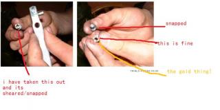

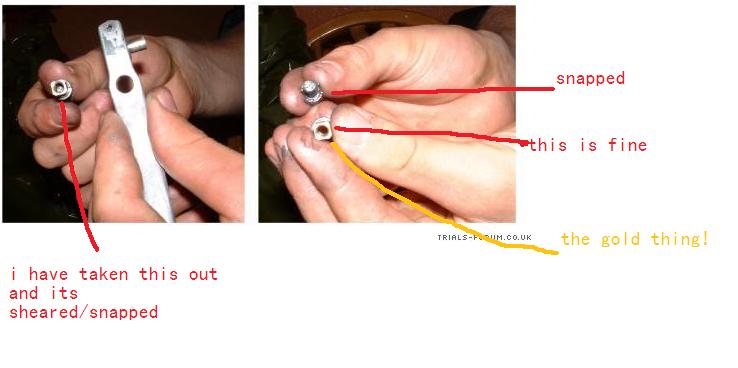

I have followed the wiki and got to the stage where i need to put a m5 bolt in it. surely when you screw the bolt into the "gold thing" and you want to adjust the tpa wouldnt the gold thing move causing the bolt to not move in more to push the pistons out?
Is it the Old style lever blade because i know how to fix it if it is.
Edit.
Just had another look at picture looks like it is, just get a bottle rack bolt and replace it, it works fine iv got one in mine cut a slot in the head end it helps.
Edited by Earl
Thats why you hold the 'gold thing' with your other hand - you've got two for a reason ;)
what? this is silly
Slide the gold thing into the lever and hold it still using you're left index finger. Then using your right hand, screw the bolt in. I don't see how thats hard to understand.
Then you can either place the sheared bit off (which goes either side of the piston rocker) in place and put the lever back together (the force of the new m5 bodge bolt against the plate will stop it coming out)
OR I think you can just use the bolt on its own against the piston rocker
