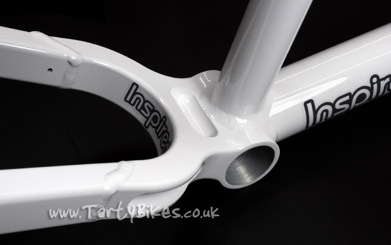

Alternative would be for the MK2 inspired to take a 26" wheel ... as it has long enough stays - it just needs some love in the mounts department and CS yoke ...

Dont just get what you mean by a CS yoke, doesnt it already have one?

I dont think you can fit a 26" wheel in an inspired because of the way the CS yoke is designed ...
so CS length is fine for a 26 but doesnt have the clearance .... :(

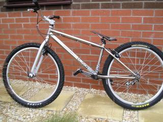

I know all these people who don't own one are saying how this frame was shit but I really like the Freetrials....last time I rode a bike everyone had to have little xc frames cos there was nothing else, then last year I decided to give it another go and bought this. For someone who never went through the luxury of riding featherweight competition bikes with +30 bb heights it feels spot on for me....and I think apart from on comp bikes, we're due a return of the seat.
(spec now totally changed from this pic)
That looks no bad son.
Stick up some recent pictures of it side on for us lot to have a gander :)
It's in bits in my dining room!..I'll get some up once it's built again.
This is the only side on pic I have of one (my mates, not mine)...
I bet if you leant hard enough on those poor double walls they'd spin all the way round
Leon
Not sure what you mean...in the stem?
Probably because they are so far forward facing.
