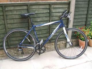

Mr Plod Posted June 14, 2009 Report Share Posted June 14, 2009 (edited) Need some help chaps.Want to dig my Hybrid out the shed and start commuting to work on her again.Basically she's got 700cc wheels which are fine except they don't really handle the potholed roads around here too well so would prefer a smaller wheel with a larger slick tyre. Also I'll be running discs front and rear so any suggestions as to wheels please? I don't want to spend alot... Edited June 14, 2009 by Mr Plod Quote Link to comment Share on other sites More sharing options...
Robwalker Posted June 14, 2009 Report Share Posted June 14, 2009 Personally i'd try and stick with the 700 wheels. Although at first they may be a bit wobbly once you get used to them they will be a great benifit. Could always go down the line of a wider profile tyre, something like a 700 x 35c, looks like your running a 28c at the mo, but that is all dependant on tyre clearance. I would recommend continental, have a look on there website as they have an extremely vast range. With regards to wheels your best bet will probably be some second hand ones from ebay, that way you can still get a decent set but at a more realistic price. Any Mavic, Shimano, DT Swiss, Campag gear will be spot on. Quote Link to comment Share on other sites More sharing options...
Mr Plod Posted June 14, 2009 Report Share Posted June 14, 2009 Personally i'd try and stick with the 700 wheels. Although at first they may be a bit wobbly once you get used to them they will be a great benifit. Could always go down the line of a wider profile tyre, something like a 700 x 35c, looks like your running a 28c at the mo, but that is all dependant on tyre clearance. I would recommend continental, have a look on there website as they have an extremely vast range. With regards to wheels your best bet will probably be some second hand ones from ebay, that way you can still get a decent set but at a more realistic price. Any Mavic, Shimano, DT Swiss, Campag gear will be spot on.What sort of size would you recommend to down scale? My mates dad chose had a decent Hybrid and either had 26" or 24" with discs and it looked and rode really well. Quote Link to comment Share on other sites More sharing options...
Robwalker Posted June 14, 2009 Report Share Posted June 14, 2009 26" at the smallest. The whole concept behind smaller wheels is to enable you to navigate through rough terrain easier, there's no need for this in what i would assume your commute would be hence why i would recommend sticking to 700. 90% of the specific hybrid bikes out there are 700c, but what we have been selling alot of lately are mountain bikes which the customer has then adapted to become more of a hybrid (slick tyers, bar ends ect..). Also personally speaking i think disk brakes are a bit too powerful for hybrid bikes, sure there good when your tearing down a hill at 40mph and your tyers and rims are getting caped in mud which would pretty much make any sort of rim brake useless, but for stopping at a set of traffic lights the kind of brakes you have on there at the moment are about right. Another problem you may also come accross is finding some 26" rims/tyers narrow enough to sit inside your existing frame and fork set-up. The only 'decent' hybrid i know of that is 26" is the Carrera Subway, which also comes with disk brakes, sounds alot like the one you mentioned in your post. This one by any chance? Obviously all the info i'm giving you, is just information, and if you feel more comfortable then by all means go for a smaller wheel, but honestly, i don't see anything much wrong with the bike as it is currently... Quote Link to comment Share on other sites More sharing options...
Fixed Pants™ Posted June 14, 2009 Report Share Posted June 14, 2009 26" at the smallest. The whole concept behind smaller wheels is to enable you to navigate through rough terrain easierlol.And don't go for campag, 95% of their wheels have campag freehub bodies which will only take a campag cassette, which won't work too well with your shimano stuff...Eric, 26" will be fine, almost...My mtbs wheels are actually taller than my 700c road wheels, so crank strike will be no problem, it'll effectively be the same bike, but with much more squish, at least compared to a thinner tyre, cos by the time you've hit the rim on a 700c wheel, you'd still have quite a bit more distance, so you won't pinch etc. A set of 1.9 (i'm sure they come in 1.6 and 1.9) conti sport contacts will be awesome, very slick but have a tiny bit of a groove on them... Nice and quick.There's nowt wrong with discs if you know how to ride a bike, given you ride trials i'd say you know how to use your fingers. Obviously they're a lot more powerful than rim brakes but you're not exactly gonna send yourself over the bars. Straighten up those bar ends and get rid of the wheel reflectors! Quote Link to comment Share on other sites More sharing options...
Robwalker Posted June 14, 2009 Report Share Posted June 14, 2009 (edited) Okay, maybe not the whole concept, but everyone with half a brain knows that MTB evolved from cyclocross, as smaller wheels made it easier?... And you really think there's going to be clearance in that frame and fork for 26"? I take that back, continental do a 26" UltraGatorskin =/ Trying to find a rim to accommodate a 1.2 tyre may be a problem though...And what on earth do you mean they are taller? The only way that's possible is if your running some beastly tyre which clearly isnt an option on this frame and fork?! Edited June 14, 2009 by Robwalker Quote Link to comment Share on other sites More sharing options...
Fixed Pants™ Posted June 14, 2009 Report Share Posted June 14, 2009 Okay, maybe not the whole concept, but everyone with half a brain knows that MTB evolved from cyclocross, as smaller wheels made it easier?... And you really think there's going to be clearance in that frame and fork for 26"? No, smaller wheels are tougher, the bigger the wheel, the better it rolls, and the better it'll roll over big holes. Hence 29ers, 69ers.Given that frames and forks generally taper, hopefully it'll pull it down just enough to put a 1.6 in there, which isn't too wide, maybe i was being a bit ambitious with the 1.9 but a 1.6 will be an improvement anyway.I take that back, continental do a 26" UltraGatorskin =/ Trying to find a rim to accommodate a 1.2 tyre may be a problem though...I have had a 1" gatorskin on a halo combat, no problem.And what on earth do you mean they are taller? The only way that's possible is if your running some beastly tyre which clearly isnt an option on this frame and fork?!As in, if i put a spirit level on top of my mtb tyre, and held it level, my 700c wheel would pass under it. It's a 2.1, so he'll drop the axles about half an inch, negligible. I haven't seen the clearances but it might happen.And also, Eric, if you fancy buying a new bike, GT zum s2 will probably fit the bill very well. Quote Link to comment Share on other sites More sharing options...
Robwalker Posted June 14, 2009 Report Share Posted June 14, 2009 Everythings an argument with you. Yes smaller wheels are tougher, but were talking road use here, and you just said yourself they roll better...Combats are wider than 1" so your talking bollocks, not to mention at no point in time would there ever be the need for that setup...And it wont happen.. The guys after sorting out his old bike not buying a new bike, i was just trying to save him what would be alot of hassle and probably a fair amount of money. Why do i even bother trying to offer advise? Quote Link to comment Share on other sites More sharing options...

Mr Plod Posted June 16, 2009 Report Share Posted June 16, 2009 Cheers for the help guys. Glen, Robs right, I'm not after getting a new bike just want to make mine a bit more friendly for the ride to work as the roads here are absolutely shocking. I can't remember if I made reference to my mates Dads bike when I originally asked for advice but here is the one he owns...Here's a spec of the wheels...Rear Hub Shimano, 32 Hole Disc with Locking QRFront Hub Shimano 32 Hole Disc with Locking QRSpokes DT 14 Gauge Black StainlessRims Mavic XM-317, 32 Hole DiscTyres Continental Sport Contact, 26” x 1.6” with Safety SystemThat's the sort of wheels I'm looking for and that set up would be ideal for my commute to and from work so yeah... Any where I can get that wheel set or is it just a case of buy the parts and get them built up myself?Cheers for the help guys. Quote Link to comment Share on other sites More sharing options...

Fixed Pants™ Posted June 18, 2009 Report Share Posted June 18, 2009 (edited) Go to any raleigh dealer and ask for a probuild of the closest spec they have of that. Fairly sure they do deores on 317s though... About 70 quid each iirc? (my shop can get em in) same with the tyres, any conti dealer, probably the same shop...How tall are you dan? And what's your inside leg? Edited June 18, 2009 by Fixed Pants™ Quote Link to comment Share on other sites More sharing options...

Robwalker Posted June 18, 2009 Report Share Posted June 18, 2009 Any one able to assist with my post above?You may beable to get that exact wheelset, finding where from may be a problem though...Give us a price range budy, for something similar, with the way prices are at the mo, i'd look to spend about ÂŁ120ish.cheers , what size frame do you have on the road bike ? and how tall are you ?because i cant decide between the small or medium lol.It a Medium, and given your height i'd go for a M too. Do what FP says just to make sure! P.S.Dont let the monkey size you up on a medium carrera!!! Quote Link to comment Share on other sites More sharing options...
