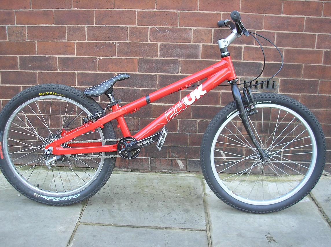

Ollie Histon Posted May 18, 2009 Report Share Posted May 18, 2009 Are there actually any saddles which are slammable to the 24uk mk2? Looking for a really short length seat... Quote Link to comment Share on other sites More sharing options...
monkeyseemonkeydo Posted May 18, 2009 Report Share Posted May 18, 2009 Are there actually any saddles which are slammable to the 24uk mk2? Looking for a really short length seat...If you run one with rails and run an offset seatpost back to front you should be able to get away with it... Or just buy an Inspired. Quote Link to comment Share on other sites More sharing options...

sstein Posted May 18, 2009 Report Share Posted May 18, 2009 (edited) What about bmx style micro-adjusts or integrated seat/post? Edited May 18, 2009 by sstein Quote Link to comment Share on other sites More sharing options...
Revolver Posted May 18, 2009 Report Share Posted May 18, 2009 What about bmx style micro-adjusts or integrated seat/post?Depends on the size of the post. I know eclat do one, the complex, but it's also bmx sized seatpost, which doesn't fit an inspired. I'm assuming the 24uk is the same seatpost size though, if it's actually bmx sized, no problem What I mean is, there aren't very many/any 27.2 integrated post/seats.Pivotal setup? Quote Link to comment Share on other sites More sharing options...
sstein Posted May 18, 2009 Report Share Posted May 18, 2009 Run an adaptor. Halfords sell 'em for a few pounds. Quote Link to comment Share on other sites More sharing options...
Ollie Histon Posted May 19, 2009 Author Report Share Posted May 19, 2009 Pivotal setup?Yeah thats what i was hoping, but judjing my most pictures ive seen most seats will still hit the tyre like in this pic. So im looking for the shortest pivotal seat there is? Quote Link to comment Share on other sites More sharing options...
Matthew62 Posted May 19, 2009 Report Share Posted May 19, 2009 (edited) Looking at it though, how would a saddle be slammable unless you ran it massively offset. The seat angle on the 24UK is rediculous. The saddle would need to end around 1cm behind the seat tube - i doubt you'll ever get that with a pivatol set-up.You'll just have to run a railed saddle and hoik it a long way forward - it will look a bit shit, but you don't have much option. I'm still unsure why the seat angle is as extreme as it is!? Edited May 19, 2009 by Matthew62 Quote Link to comment Share on other sites More sharing options...
