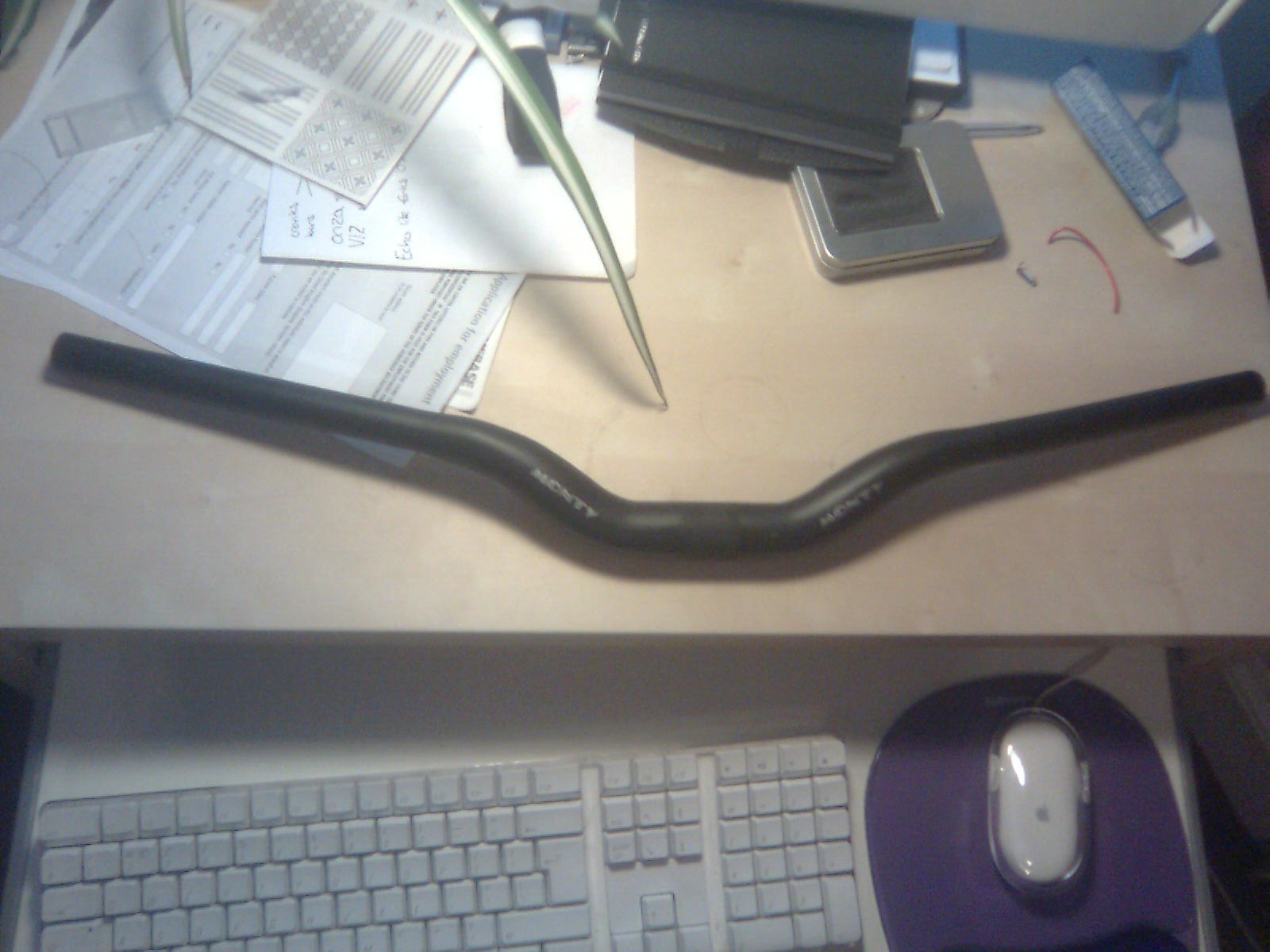

bigamac Posted May 18, 2009 Report Share Posted May 18, 2009 (edited) Right, I got some monty 219 risers in front of me that i bought.Well i been told that what they are.It does say monty on them nothing else though.Are these "oversized"?Because when I look at them they seem "chunkier" in the middle than my onza bars.If not/so would these fit with echo team stem?Answers asap please.Cheers, luke. Edited May 18, 2009 by bigamac Quote Link to comment Share on other sites More sharing options...
Luke_zoo Posted May 18, 2009 Report Share Posted May 18, 2009 Right, I got some monty 219 risers in front of me that i bought.Well i been told that what they are.It does say monty on them nothing else though.Are these "oversized"?Because when I look at them they seem "chunkier" in the middle than my onza bars.If not/so would these fit with echo team stem?Answers asap please.Cheers, luke.They are over sized, I have them on my mod Quote Link to comment Share on other sites More sharing options...
Skoze Posted May 18, 2009 Report Share Posted May 18, 2009 Try them and see?And yeah, i'd say they are. Quote Link to comment Share on other sites More sharing options...

Dave Anscombe Posted May 18, 2009 Report Share Posted May 18, 2009 Pretty shure they are monty 220 risers baisicly the same as try all rage bars to running them with the try all nuc stem is a good idea Quote Link to comment Share on other sites More sharing options...
Ali C Posted May 18, 2009 Report Share Posted May 18, 2009 they are monty 219 bars. They have a oversized 31.8mm clamp (pretty much the industry standard in trials).The bars are fairly tall, so I would recommend a slighty lower stem, something along the lines of the Trialtech forged, Monty 219 stem or the Try-all NUC. Quote Link to comment Share on other sites More sharing options...
psycholist Posted May 18, 2009 Report Share Posted May 18, 2009 Hard to judge from the picture, but if the diameter of the centre clamp is 31.8mm it's oversized so look for a 31.8mm clamp stems for it... Quote Link to comment Share on other sites More sharing options...
ginger allen echo Posted May 18, 2009 Report Share Posted May 18, 2009 The 219 risers will fit the Team stem. Iv'e used the Team stem with them before and it's fine.Iv'e now got the sl stem with the old 219 risers and theyr'e perfectly fine.Ginger Allen Quote Link to comment Share on other sites More sharing options...
bigamac Posted May 18, 2009 Author Report Share Posted May 18, 2009 Cheers Ali i measured up roughly and there about that measurement. I just don't know what stem now. The maximum I can go is £35. Quote Link to comment Share on other sites More sharing options...
Ali C Posted May 18, 2009 Report Share Posted May 18, 2009 I would deffo recommend the Trialtech forged 20". Its slightly lower than the other Atomz or Try-all oversized stems but you can still use a normal topcap unlike with the Monty 219 or Try-all NUC stem (which are really meant for flat bars anyway). Quote Link to comment Share on other sites More sharing options...
