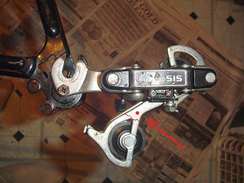

Polish Petee Posted April 26, 2009 Report Share Posted April 26, 2009 (edited) Hello, I'm using one of these at the moment and they are absolutely awsome.The good thing about them is that you can Huck it behind your hub bolt or you quick release, so you don't need a mech hanger.you can also modify them to make them a short cage!! All you have to do is simply drill it!!! You will need a M5 drill bit for metal, a drill, Maggie bolt with 2 nuts to go on the bolt and a hacksaw!As you can see on the picture the little red line is where you should cut with the hacksaw and the red spot is where you should drill. But remember to line the holles up with each other before drilling so you know that the bolt is seating straight. it gives you a really good tension and it is so easy to set up!! It's a little bolt that you just tight up and the tensioner is moving to wards the wheel. Basically you just move the jockey wheel a bit further up. Have a go, Its easy!!!Peter Edited April 26, 2009 by Polish Petee Quote Link to comment Share on other sites More sharing options...
