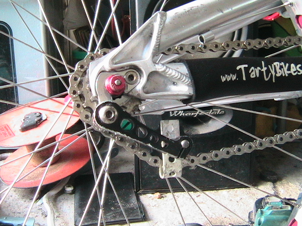

trialschallenger Posted April 25, 2009 Author Report Share Posted April 25, 2009 i have a sprung one single wheeled rather like thishow do i get it to tension the other way Quote Link to comment Share on other sites More sharing options...
Cookyboy Posted April 25, 2009 Report Share Posted April 25, 2009 Think you need to remove the little pin thing? Quote Link to comment Share on other sites More sharing options...

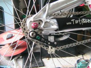

trialschallenger Posted April 25, 2009 Author Report Share Posted April 25, 2009 (edited) there we goignore the brass bit,thats comeing off,i though it was the chain tensioner i put that on there to guide the chain Edited April 25, 2009 by trialschallenger Quote Link to comment Share on other sites More sharing options...

Ali C Posted April 25, 2009 Report Share Posted April 25, 2009 its 100% the chain jumping over the rear cog. If you have an old mech or something you can bolt that on quickly and see if the skipping stops. Quote Link to comment Share on other sites More sharing options...
trialschallenger Posted April 25, 2009 Author Report Share Posted April 25, 2009 its 100% the chain jumping over the rear cog. If you have an old mech or something you can bolt that on quickly and see if the skipping stops.hit the nail on the head there managed to get an old one at the back of my garage,it isnt overly great its bloody noisy,would a kings 74 be any goodcheers all Quote Link to comment Share on other sites More sharing options...
