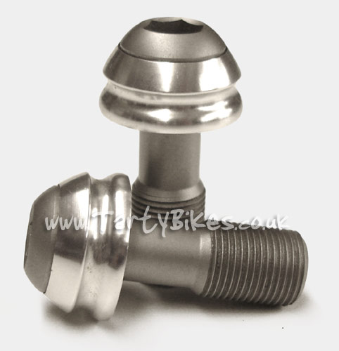

Those bolts will only fit the Chris King BMX hubs though, the 135mm spacing Ck hubs with HD axles use what looks like an M12 fine (or imperial equivelent) thread which is then turned down where the bolt goes through the frame, as it is not possible to fully remove a CK funbolt whilst the hub is still in the frame.
See picture:
Adam
Take Note!
