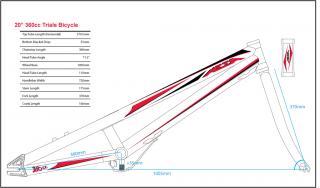

middleageman Posted March 26, 2009 Report Share Posted March 26, 2009 As said above, also, this may help you understand the geometry of a bike as it did me;The wheelbase of this Meta 20" mod = 1005 mm. Quote Link to comment Share on other sites More sharing options...
