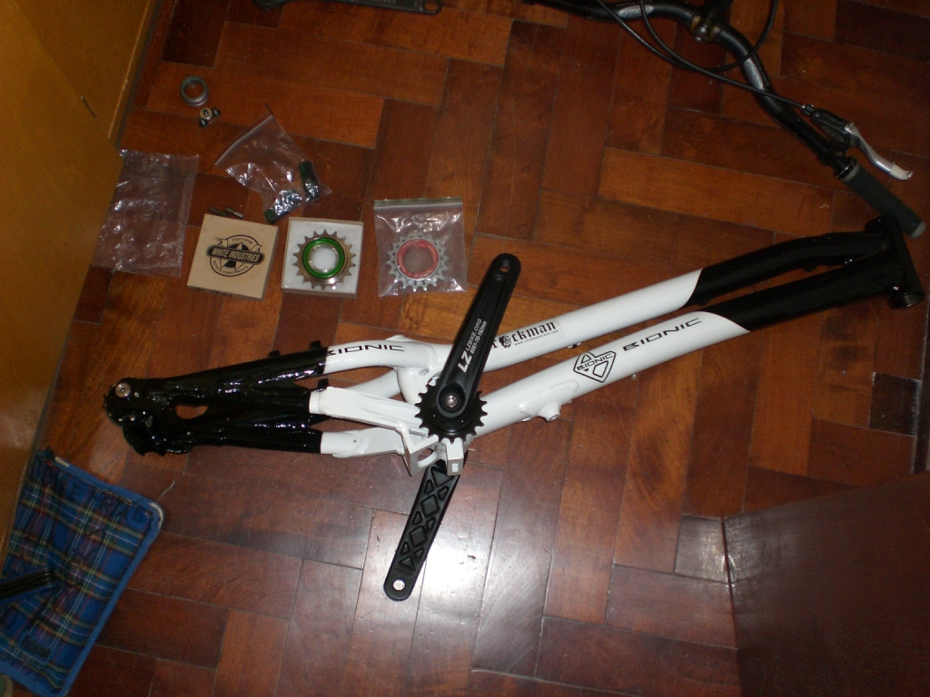

pablotrial Posted March 25, 2009 Report Share Posted March 25, 2009 hi peoplei have just bought a bionic b-4 20" and i was setting up my chain and i couldn't. if i take out one link its too tight and if i put one more, the axle comes out of the dropouts,thera are no half links available here,mi chain is a brand new kmc bmx 1/2x1/8,what can i do?how can i make the chain to strech??please heeeelp me i wanna ride mi bikethats the frame only but i have the complete bike now Quote Link to comment Share on other sites More sharing options...

Muel Posted March 25, 2009 Report Share Posted March 25, 2009 Whats that drilled freewheel and what are those cranks?I'd made a little tensioner for my Echo once:http://www.trials-forum.co.uk/forum/index....=123188&hl=Some info dotted around in there about it. Worrked well though! I just used the plates and the spacer out of a jockey wheel and a nut and bolt through the little plate. Quote Link to comment Share on other sites More sharing options...

Sponge Posted March 25, 2009 Report Share Posted March 25, 2009 (edited) Muel, and those who asked: It's the new 108ep Worldcat freewheel, I believe? I saw pictures of it on Fatihbike.cn not long ago. The Americans have had those in stock for a while, maybe it's worth asking OTN for the lowdown on these.For BMXs, we just buy an individual halflink and no more needs to be said. However since trials is a lot more drivetrain-dependent, it's a risk. Why not just run a halflink for a little while, a few days. Let the rest of the chain bed in and stretch, and then when you get fed up of the halflink just replace it with a normal link. Then since the chain's stretched already, it'll be betteredit: if it's a KMC kool chain, they do stretch quite a bit during the bedding in process Edited March 25, 2009 by Sponge Quote Link to comment Share on other sites More sharing options...

pablotrial Posted March 26, 2009 Author Report Share Posted March 26, 2009 THANK YOU FOR ALL REPLIESvery useful tips lolreally thank younoothe dirlled freewheel is a worldcat 72ep 09 modeland the freewheels are for some friends that included them in the shippingthan you guys, i think ill make the little tensioner until the chain streches or ill put the chain really thigt but in my 26 lolthankss ;)Whats that drilled freewheel and what are those cranks?I'd made a little tensioner for my Echo once:http://www.trials-forum.co.uk/forum/index....=123188&hl=Some info dotted around in there about it. Worrked well though! I just used the plates and the spacer out of a jockey wheel and a nut and bolt through the little plate.the cranks are LZ 162 mm i bought them in colombia really cheapthe freewheel is worldcat 72 ep 09' Quote Link to comment Share on other sites More sharing options...
