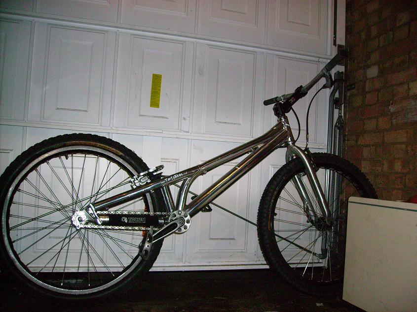

Muel Posted March 22, 2009 Report Share Posted March 22, 2009 (edited) Mod or Stock? I'm guessing it'll be a splined rear sprocket, you can only get 12t wide based splined sprockets I seem to remember.EDIT: I've been running 16:13 with a KMC Z610 chain for about 6 months, it's never missed a beat! Edited March 22, 2009 by Muel Quote Link to comment Share on other sites More sharing options...
N.Wood Posted March 22, 2009 Report Share Posted March 22, 2009 Take this as a compliment Muel, but by the looks of things you don't put too much stress through a chain? Quote Link to comment Share on other sites More sharing options...

Muel Posted March 22, 2009 Report Share Posted March 22, 2009 Not these days, it hardly gets used at the moment. I don't have a lot of power but Stan Shaw was running the same chain and cranks as me though on his XR26, I don't think he had any problems either. I wasn't really making a point, I thought it would have snapped by now, I've heard about these rings snapping chains really easily. Quote Link to comment Share on other sites More sharing options...
