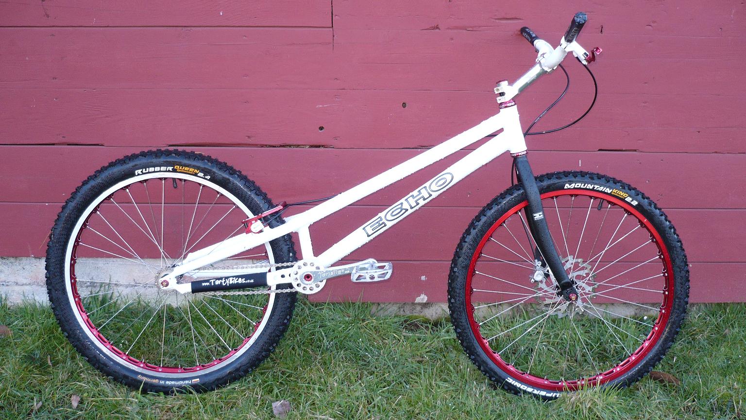

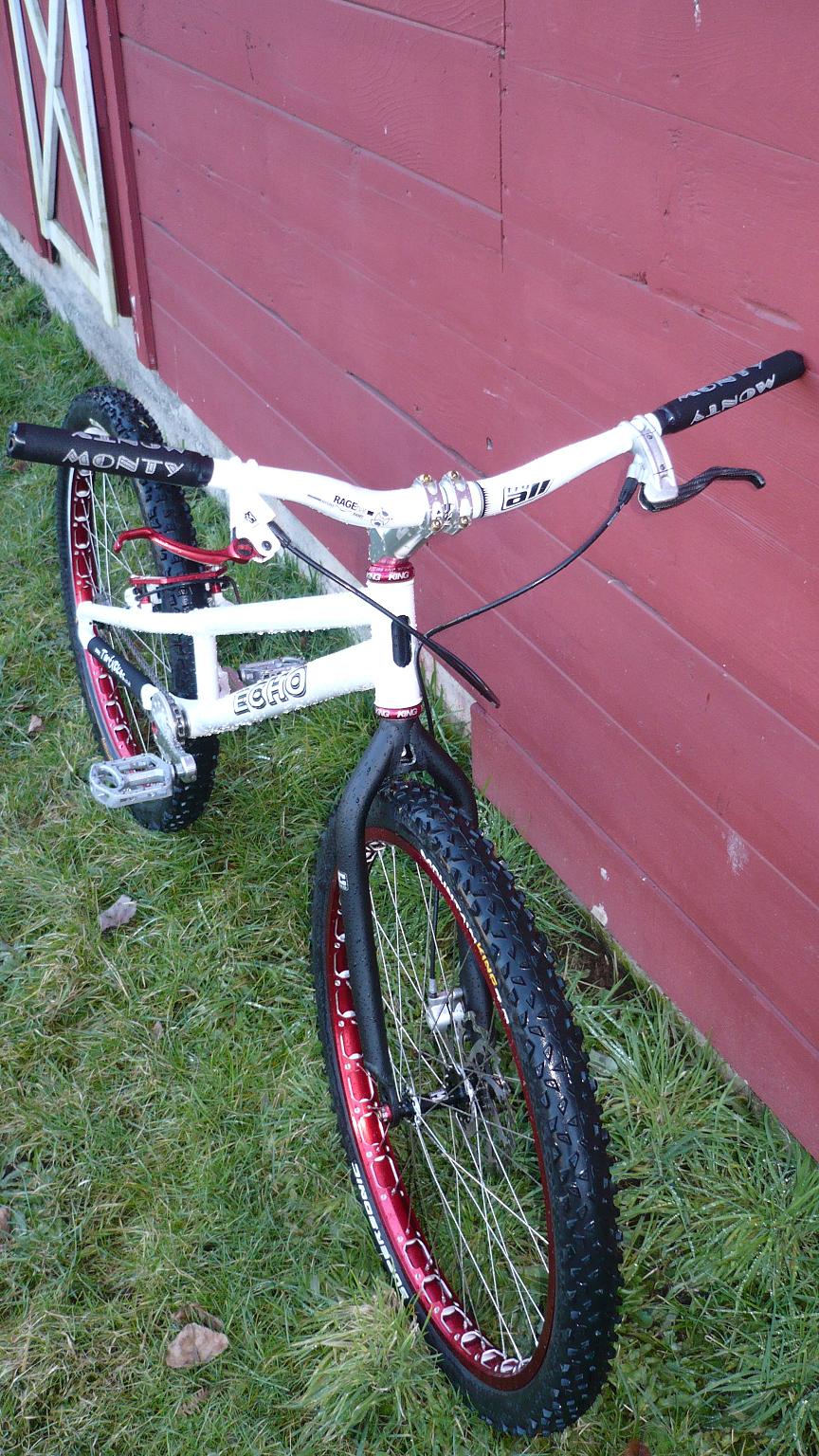

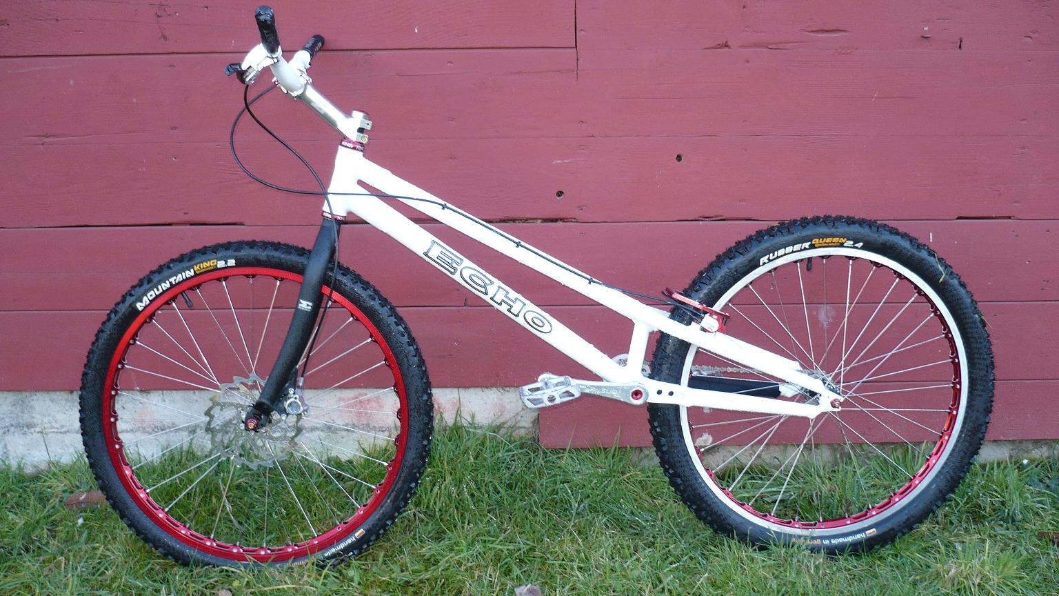

BrettM Posted February 12, 2009 Report Share Posted February 12, 2009 '09 Echo Control frame long - 1634gEcho SL fork - 708gChris King headset - 106gEcho SL stem - 206gTry All Rage bar - 290gMonty foam grips - 15gEcho BB - 268gTensile cranks - 524gWhite Industries freewheel - 200gWellgo Mag. pedals - 366gSram PC 890 chain - 208gTarty chainstay protector - 12gMagura Marta 180 mm disk brake - 406gMagura rim brake w/ Echo SL booster - 356gEcho SL front rim on the rear - 608gEcho SL rear hub - 180gEcho cog - 44gDT Revolution spokes - 130gDt Alu. nipples - 10gGeneric tube - 188gContinental Rubber Queen 2.4 rear - 825gEcho SL front rim - 604gEcho SL front hub - 138gDT Revolution spokes - 130gDT Alu. nipples - 10gGeneric tube 188gContinental Mountain King 2.2 front - 506g8.86 kg or 19.53 poundsI still have to trade for the lower, shorter stem. Chris had some longer, higher stems sent to him by mistake and I got one. I'm probably gonna paint the fork white. I've always had white forks. I'm gonna switch to a Hope Trials brake one day and put the Magura disks on another bike.Other than that I gotta figure out some brake clearance issues. I was planning on using the Echo front rim on the back when I still used a small 2.2 rear tire. Now that I'm using this giant tire I don't know how long that will last. The good part is I have decent crank arm clearance, but as the pad wears its gonna be tough to get the brakes pushed in far enough. On the flip side with the wide rim and new pads the cranks rub the brakes under pressure. So I'm looking at my options with that for now. Quote Link to comment Share on other sites More sharing options...

Damon W Posted February 13, 2009 Report Share Posted February 13, 2009 but as the pad wears its gonna be tough to get the brakes pushed in far enough.tensile 4 bolt mounts? Quote Link to comment Share on other sites More sharing options...

BrettM Posted February 13, 2009 Author Report Share Posted February 13, 2009 tensile 4 bolt mounts?I hoped so, but they won't work. Even though you could flip them around to help push your brake in farther in theory the brakes are tall enough they will hit where the bolt goes through the mounts and into the frame. There is just no way around that no matter what your mount looked like. I could file the mounts down some and come up with an extra few mm's. Maybe use the tpa to push the pads in as well. I'll probably just switch back to the wider rim though. I only really wanted to use the narrower rim when I had the narrower tire. Quote Link to comment Share on other sites More sharing options...
