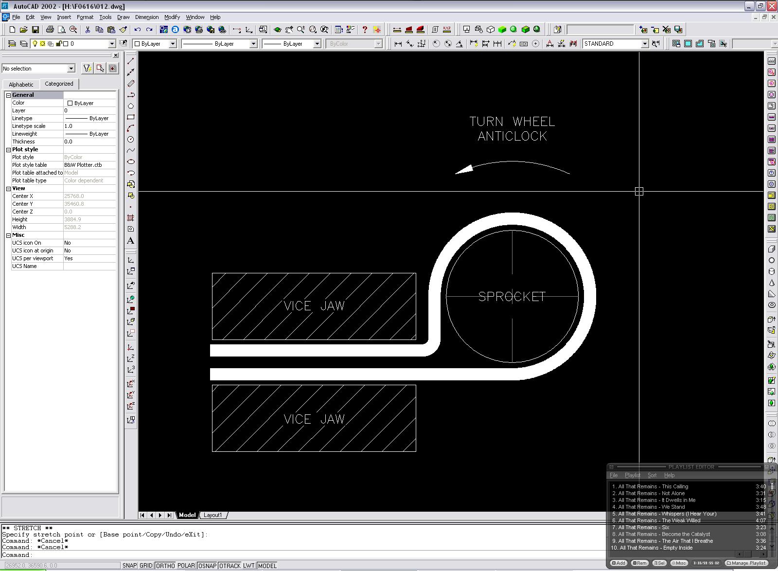

forteh Posted February 6, 2009 Report Share Posted February 6, 2009 (edited) Hi, you could try heating it. Stick it in a vice, heat round the sprocket, on the thread with a blow torch, then use the chain whip and it should come off. The heat will make it expand and it should then come off.May not work, the aluminium crank will expand faster than the steel sprocket and likely wedge it on tighter If you have a decent sized vice that is bolted down to a solid bench/the floor then you should be able to hold the sprocket with some chain, stick a decent sized steel pipe over the crank arm and twist it off.See this handy autocad sketch that I did a little while ago (obviously replace wheel with crank arm )edit: waay too slow, muel got in there whilst I was searching for that acad sketch - bah! Edited February 6, 2009 by forteh Quote Link to comment Share on other sites More sharing options...

Henrik Y Posted February 8, 2009 Report Share Posted February 8, 2009 (edited) I had the same problem. Tried wood blocks but that just got into toothpicks. I took the thickest chain that I had and wrapped it around the sprocket and clamped it in the vice as shown in earlier post. Then I put a larger nail trough the chain on the other side to stop it from slipping. Then I had a friend to hold the workbench and a 2m long iron pipe on the crank. My weight wasn't enough so I had to jump and pull it and almost cracked the bench. Steady workbench with a large vice and much force is what you need. But if you are lucky it may go easier then it did for me, I didn't grease it when screwing it on Edited February 8, 2009 by Henrik Y Quote Link to comment Share on other sites More sharing options...
