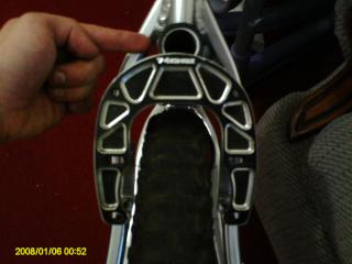

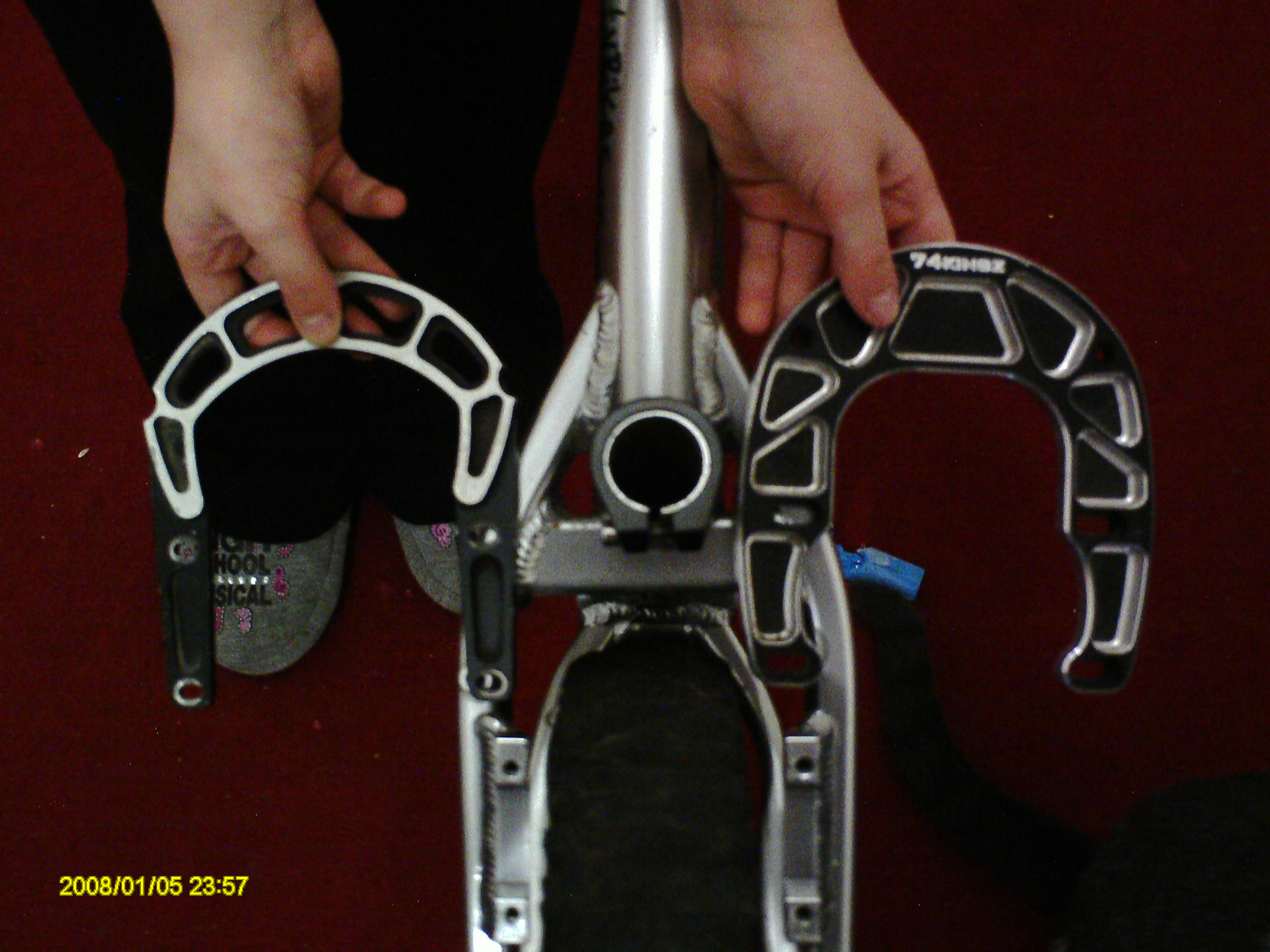

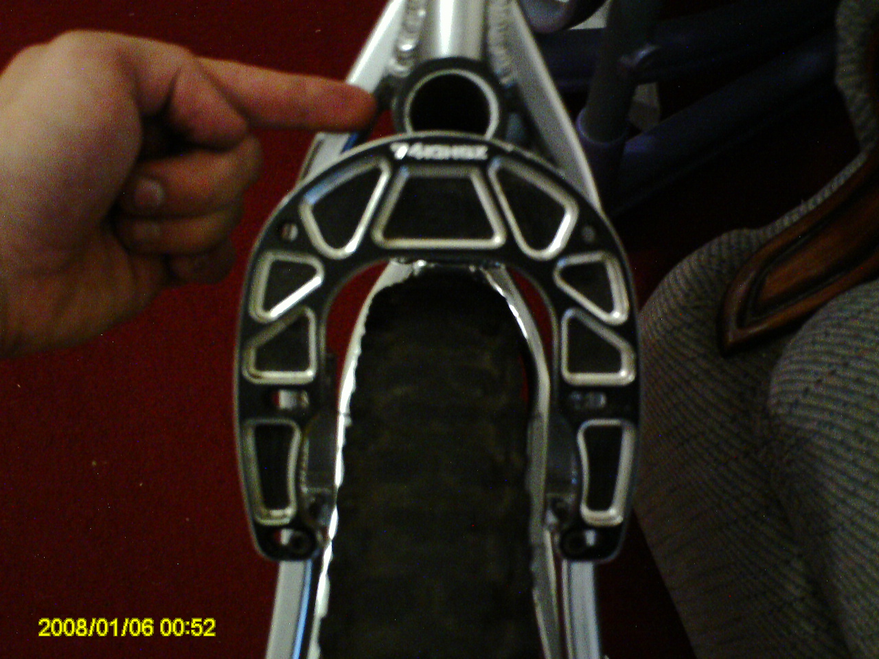

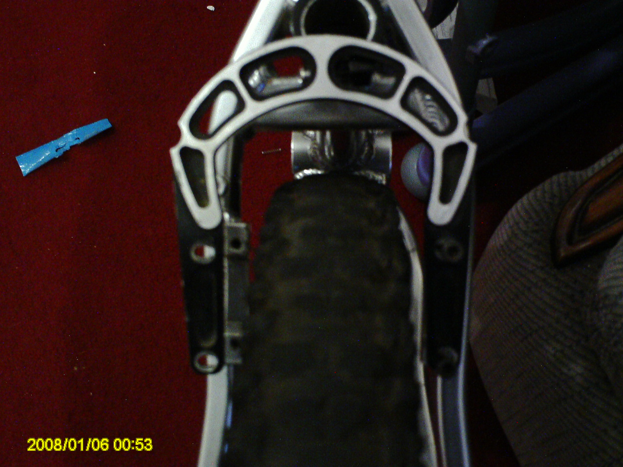

Right got two boosters one R n D and the other a 74 trialskings and neither fit
the rnb is just too wide and will simply not work
the other is the 74 and with it fitted i cant put the bloody seat in
can someone advise me on a booster than will fit in a saracen frame and allow me to put the seat in
its a saracen 2.6 btw
will be fitting some offset mounts to so they will need to fit as well
dont want much do I

It'd be easier to see if you took a picture of it with the holes all lined up with the mounts on the frame... So we can see your problem?
I can only suggest contacting whoever you're buying the booster's off and ask them to measure from the top of the booster, to the top of the brake mounts, to see if it'd clear it?

may be worth looking at the 2 bolt boosters like the Echo on Here ... may be a little less height to them. Tarty have put the measurements on there for you to check
No help im afraid, saracen mounts are 90mm wide center to center, that booster is for 98mm+ so wouldnt work im afraid

I had the same frame as you at one point and had the same problem.
The main option is going for a 2 bolt brake booster.
http://www.selectbikes.com/index.php?act=v...mp;productId=71
