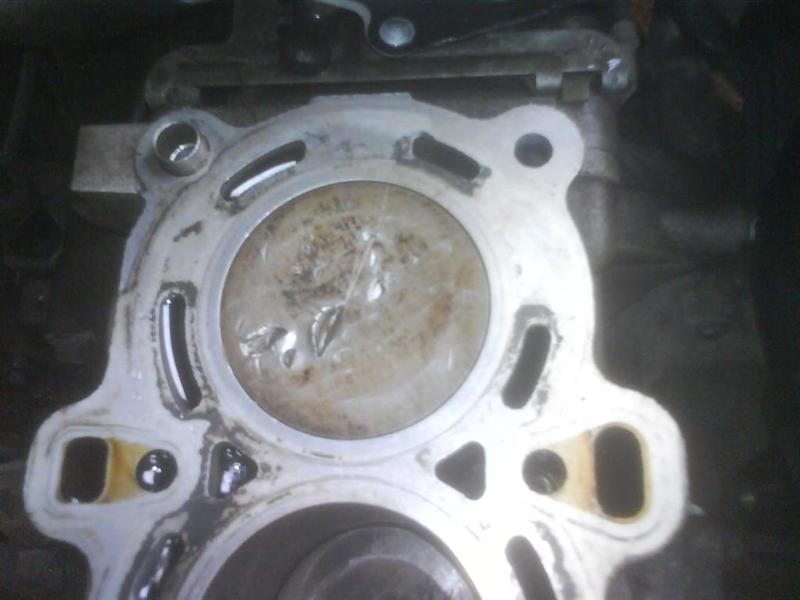

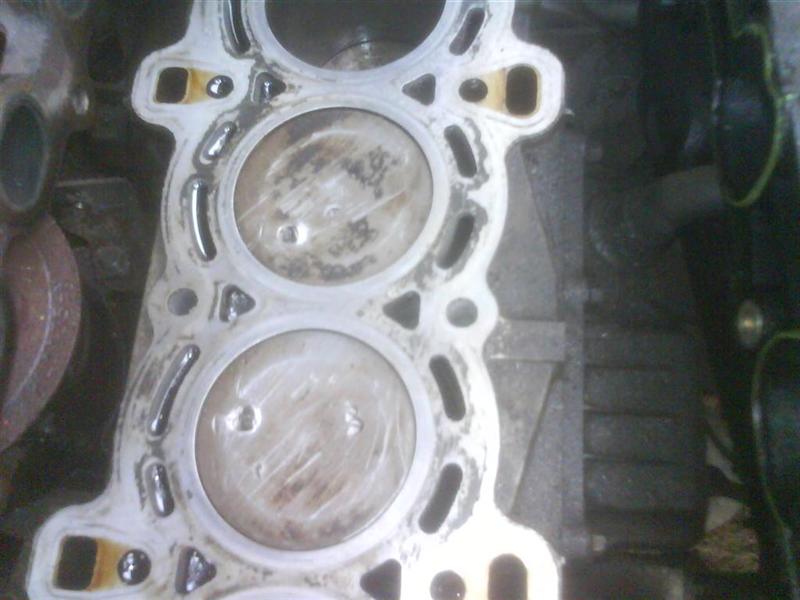

AdamR28 Posted January 22, 2009 Author Report Share Posted January 22, 2009 Right, everything is on the way to being sorted but it seems like it will be a pricey job...I've just been down to the garage to have a look: The bearing on one of the cam belt pulleys shat itself which popped the cam belt off. The rockers were destroyed (literally all in bits) and the valves bent, they had a go at re-grinding them but they were too bent for that. Luckily the block and head are ok but it will of course need a skim, new gaskets etc. and new cam belt kit. So it seems the garage were being straight with me which is good, I have used them a few times before with no problems. I'm just a bit gutted it went 40k miles before it was due... I do remember hearing a few squealing type noises at low revs while pulling away in first gear, I guess that was the sign and it's truly lesson learned now! Quote Link to comment Share on other sites More sharing options...
Will Arnold Posted January 22, 2009 Report Share Posted January 22, 2009 didn't know this engine had rockers ! is it not a standard overhead cam, with followers and valves? Quote Link to comment Share on other sites More sharing options...
Pashley26 Posted January 22, 2009 Report Share Posted January 22, 2009 How does it have rockers if the cambelt snapped Wtf's that all about.... Quote Link to comment Share on other sites More sharing options...

Will Arnold Posted January 22, 2009 Report Share Posted January 22, 2009 cambelt and rockers? lads lets work this one out!anyone got a diagram of the engine? Quote Link to comment Share on other sites More sharing options...
