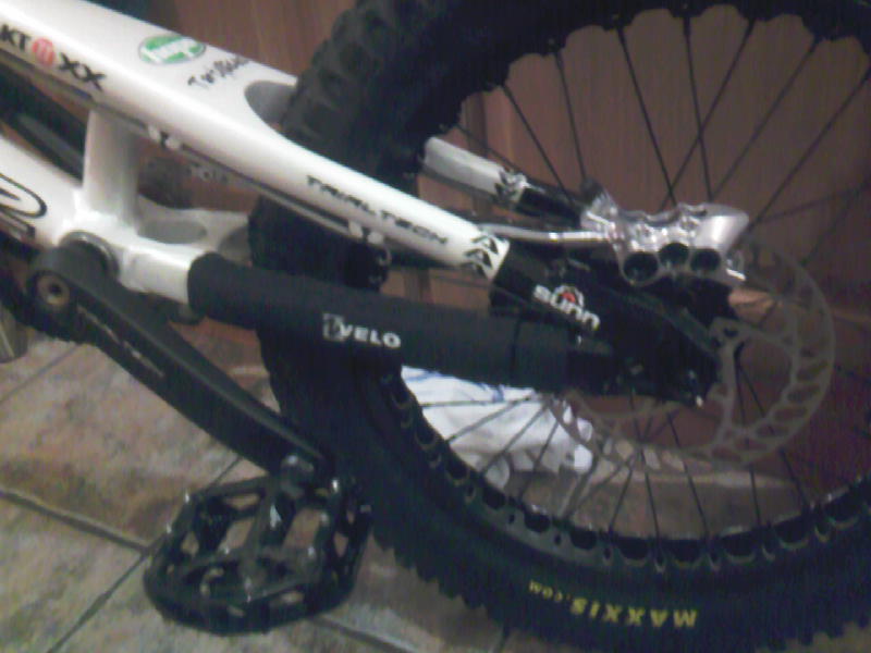

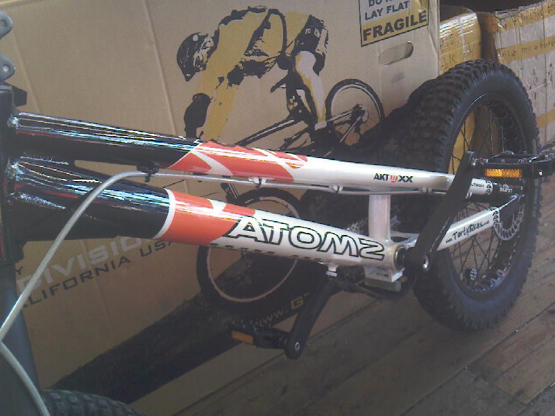

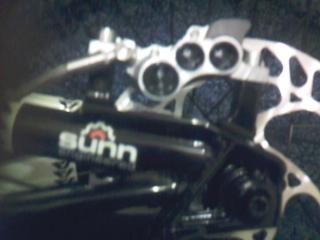

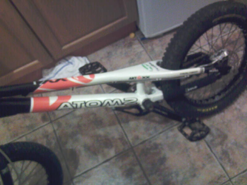

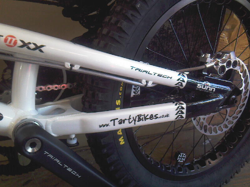

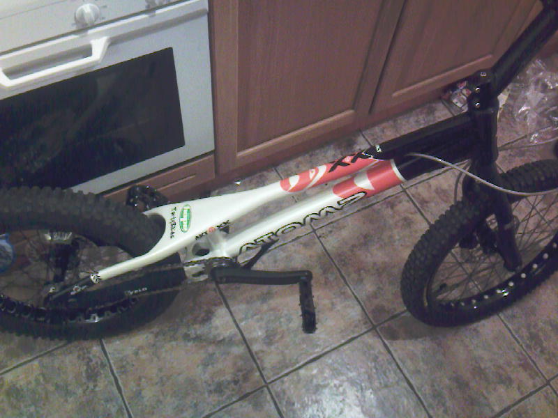

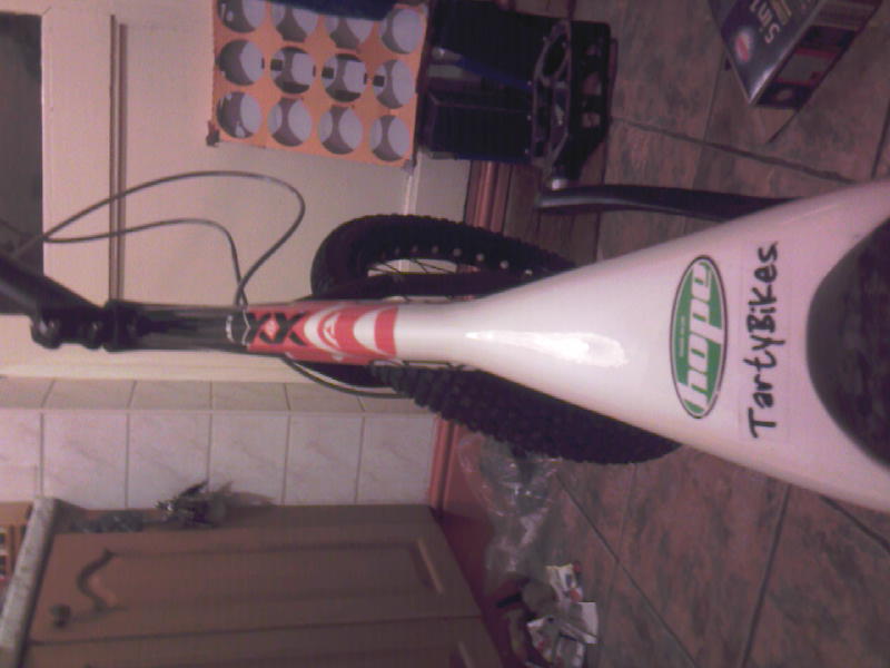

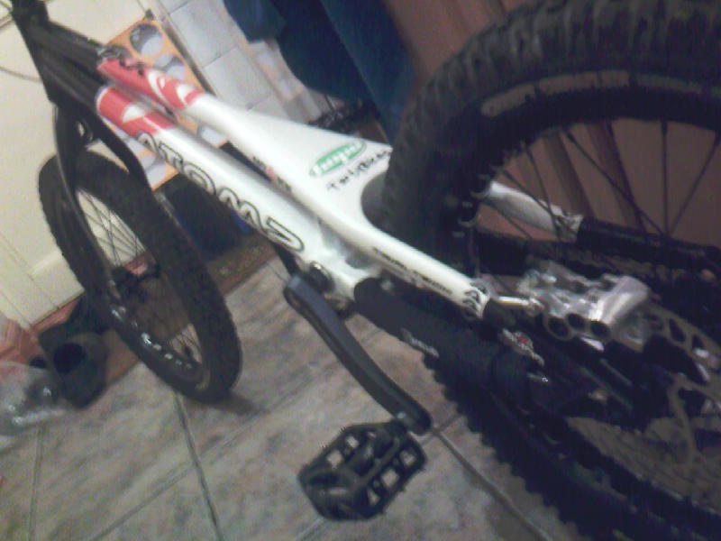

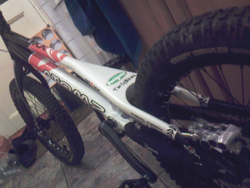

robonatomz Posted January 6, 2009 Report Share Posted January 6, 2009 (edited) finished building the little beast today, had a little ride but keen to get out on it propa at the weekend.rough spec:atomz 20"disc frame, echo light forks,echo cnc rear rim, atomz front rim,meta stem,trialtech cranks and bars and pedals, front hope mono trial, rear hope mono 6 with trial lever.for the geeks amongst you its 1020 wheelbase and weighs almost exactly 9kgthanks to adam at tartybikes and dave at trialtech for sorting all the bits out, thanks to the guys at brian rourke cycles for lending me a disc caliper till next week! lol. and thanks to cyclistdiscount.co.uk for the christmas bonus that bought it! lolso what you think people?robo photo's are off my phone, although its suposed to have a good camera, they'r not the best, but its all i have, lol Edited January 6, 2009 by onzabob Quote Link to comment Share on other sites More sharing options...
maxxis26 Posted January 6, 2009 Report Share Posted January 6, 2009 Hope mono 6 rear brake .... overkill? does look nice though Quote Link to comment Share on other sites More sharing options...
crispyboy Posted January 6, 2009 Report Share Posted January 6, 2009 Really nice bikeRide it well Should you have put this topic in bike pics ? Quote Link to comment Share on other sites More sharing options...
Greetings Posted January 6, 2009 Report Share Posted January 6, 2009 Nice bike, but it looks like you've got yourself the wrong rear brake. I'm pretty sure the Mono Trial is both lighter and more powerful. Quote Link to comment Share on other sites More sharing options...
robonatomz Posted January 6, 2009 Author Report Share Posted January 6, 2009 that it may be, but it wont fit! i can have either a moto v2 or a mono6, and the mono 6 was the only one i could find in stock anywhere without having to order it.o and sorry i didnt realise there was a bike pics bit, lol, stupid i know, maybe someone who is clever at computers can move it there for me??rob Quote Link to comment Share on other sites More sharing options...
crispyboy Posted January 6, 2009 Report Share Posted January 6, 2009 , thanks to the guys at brian rourke cycles for lending me a disc caliper till next week! lol. Quote Link to comment Share on other sites More sharing options...
tris Posted January 6, 2009 Report Share Posted January 6, 2009 Is that a Ti6?? Jeez........ Quote Link to comment Share on other sites More sharing options...
N.Wood Posted January 6, 2009 Report Share Posted January 6, 2009 Could you use a post-IS adaptor and fit a Mono Trial? Might need a larger rotor. Quote Link to comment Share on other sites More sharing options...
robonatomz Posted January 6, 2009 Author Report Share Posted January 6, 2009 i looked at doing that, but would have had a rear 180mm rotor on a 19" wheel, lol just not practical, besides, i thought it looked pimp when i fitted it, was gonna replace it with a moto v2, wich is the same as a mono trial, when its in stock, but might stick with the ti6, just cuz i think it looks ard! lol, so what if its a bit heavyer, and i dont see how it can be less powerfull, rob Quote Link to comment Share on other sites More sharing options...
Captain Scarlet Posted January 6, 2009 Report Share Posted January 6, 2009 That looks brilliant, I love the crossover area of the frame where you've put those stickers, just looks smooth and immaculate. Quote Link to comment Share on other sites More sharing options...

JonMack Posted January 6, 2009 Report Share Posted January 6, 2009 i looked at doing that, but would have had a rear 180mm rotor on a 19" wheel, lol just not practical, besides, i thought it looked pimp when i fitted it, was gonna replace it with a moto v2, wich is the same as a mono trial, when its in stock, but might stick with the ti6, just cuz i think it looks ard! lol, so what if its a bit heavyer, and i dont see how it can be less powerfull, robMoto V2 isn't the same as a Mono Trial, and the advantage with the mono trial is that it offers lots of bite and not much modulation, whereas 4/6 pot brakes offer more modulation. Quote Link to comment Share on other sites More sharing options...
robonatomz Posted January 7, 2009 Author Report Share Posted January 7, 2009 moto v2 has exactly the same pistons as a mono trial, only it on a post mount, so your right its not the same, just very very simerlar Quote Link to comment Share on other sites More sharing options...

aener Posted January 7, 2009 Report Share Posted January 7, 2009 You can afford one of those each year?Lucky you Looks nice. Always found that join looks a bit weird - not sure if I like it or not. Quote Link to comment Share on other sites More sharing options...

chimpanzyyyy Posted January 9, 2009 Report Share Posted January 9, 2009 why make a thread about a bike you have with no pic of the WHOLE bike? atomz frames are the shit, good choice, and I m sure your set up is great, but please...post a pic of the bike, not only parts and close up Quote Link to comment Share on other sites More sharing options...
Ross McArthur Posted January 9, 2009 Report Share Posted January 9, 2009 I quite like the look of that.For folk saying the rear brake is over kill, what the hell? I know id rather have a brake that held more than I wanted than less if you see what i mean. Quote Link to comment Share on other sites More sharing options...
ben_travis Posted January 9, 2009 Report Share Posted January 9, 2009 (edited) I quite like the look of that.For folk saying the rear brake is over kill, what the hell? I know id rather have a brake that held more than I wanted than less if you see what i mean.but a brake that is overkill is more likely to snap your frame? Something no-one wants to happen? Edited January 9, 2009 by ben_travis Quote Link to comment Share on other sites More sharing options...
Muel Posted January 9, 2009 Report Share Posted January 9, 2009 Having a powerful brake won't snap your frame, if the brake holds, it holds, it's your own weight that will do the damage. Quote Link to comment Share on other sites More sharing options...
Ross McArthur Posted January 9, 2009 Report Share Posted January 9, 2009 but a brake that is overkill is more likely to snap your frame? Something no-one wants to happen?Having a powerful brake won't snap your frame, if the brake holds, it holds, it's your own weight that will do the damage.Owned! Quote Link to comment Share on other sites More sharing options...
ben_travis Posted January 9, 2009 Report Share Posted January 9, 2009 (edited) im not sure i totally agree with you muel (as i believe it to be a mixture of both), but if you make ross happy then so be it Edited January 9, 2009 by ben_travis Quote Link to comment Share on other sites More sharing options...
