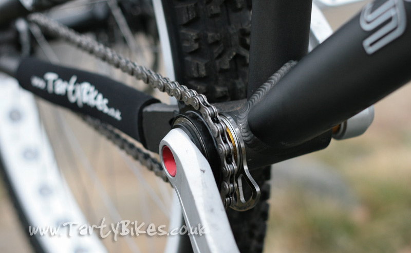

Gogz- Posted January 1, 2009 Report Share Posted January 1, 2009 Adam@TartyBikes said: Hey all,Closeup of bashring fitting (same as on Ali's bike)wow check that out ! bash ring bash plate thingDoes it actually work? longer bb? Is it strong wont you just f@ck up your bb when you smash it in to a wall . please gave me all the info Quote Link to comment Share on other sites More sharing options...

Ashley-Wood Posted January 2, 2009 Report Share Posted January 2, 2009 oh my god thats nice.. those bars look amazing shame about the price also i bet that bike just floats the bashring does it just slot on the bb? or do you need like a certain length bb i like the look of it ha. x Quote Link to comment Share on other sites More sharing options...

AdamR28 Posted January 4, 2009 Author Report Share Posted January 4, 2009 Mat Smith! said: Crank bolts look cool, why not cut a massive hole in the headtube?Could do if I can be bothered, might save 15g! Sponge said: How are those bars doing? Is the geo similar to the Rage bars? Must weigh very little! What's really curious is how exactly does that bashring fit on? Ali had that on his bike too from what I recall.The bars feel really nice, the have a little more sweep than the Rage bars. The weight is 211g! The bashring is clamped in place by tightening the BB in. Yeah Ali has the same system, I have switched mine back to 'normal' now though. pengsmelly said: The echo headset will be the reason your still over 10kg, try a new one lol.That's an SL headset, very light. N.Wood said: Good stuff, I'm gonna be annoying and ask for a full run down of changes from standard Haha, ok ok...Rear rim made single wallBrakes changed to Try-AllPrototype Trialtech SL stemTry-All Carbon barsEcho SL headsetMaxxis tubesRear HansventureReset Ti BBTrialtech Ti bashringTrialtech MG-1 Pedals with Ti axlesPrototype Trialtech SL 7075-T6 rear sprocketLoads of Ti and Alloy bolts walker said: nice bike! Get two carbon fibre lever blades and loose the stackers, you surely dont need it that high!Done the lever blades now, the stackers are there for a reason! N Roach said: Looks soo clean! Have you even ridden it yet Liken it.Haha, yes I have, quite a lot actually, just I very rarely hit anything other than the tyres. manuel said: lighter rotors, carbon blades for the winter, and lighter tyres !!!Im guessing you have already ti and ally bolted it up !!! and want to use standard bits again with no drilling ...I am thinking of trying some other rotors but the ones on at the moment work so well... I'm gonna try a Rubber Queen on the rear but I really like the feel of the Hansventure and the grip of 'proper' tyres. Onzaboymark said: No doubt Dominique's suggestion Would I be right in thinking the "1499" is the price of the bike, that also happens to double as the name?Not at all actually in this case!Yeah, 1499 is the RRP of the complete bike in Euros. Full Monty said: Any chance of sending me a high res piccy?Sure, which picture and what size do you need? alanczik said: what rear rime is it ? it looks like single wall!!It was originally a double walled version of the hOle rim with circular drillings, but I cut a wall out of it.Won't let me post all the replies properly (too many quotes) but here they are without quotes:Gogz: You can use any BB but it's best done with that bashring as it is nice and slim. The BB clamps the bashring in place. I can't see any problems unless you smash the hell out of it, although I'm a left footer which means when I miss a large gap the chain is a little exposed... so I have put it back to 'normal' now.Ben: I could, that would mean the bars are too low...Ali: Hehe, just learn to ride left footed :wink2:Stan: Don't worry, your disc will be back on soon! Ashley: Check my reply to Gogz's post, it basically just clamps in with the BB.Heath: Of course mate hahaCheersAdam Quote Link to comment Share on other sites More sharing options...

Julius Czar Posted January 12, 2009 Report Share Posted January 12, 2009 Wow, the bashring position is really cool, and the bike looks amazing. Quote Link to comment Share on other sites More sharing options...
