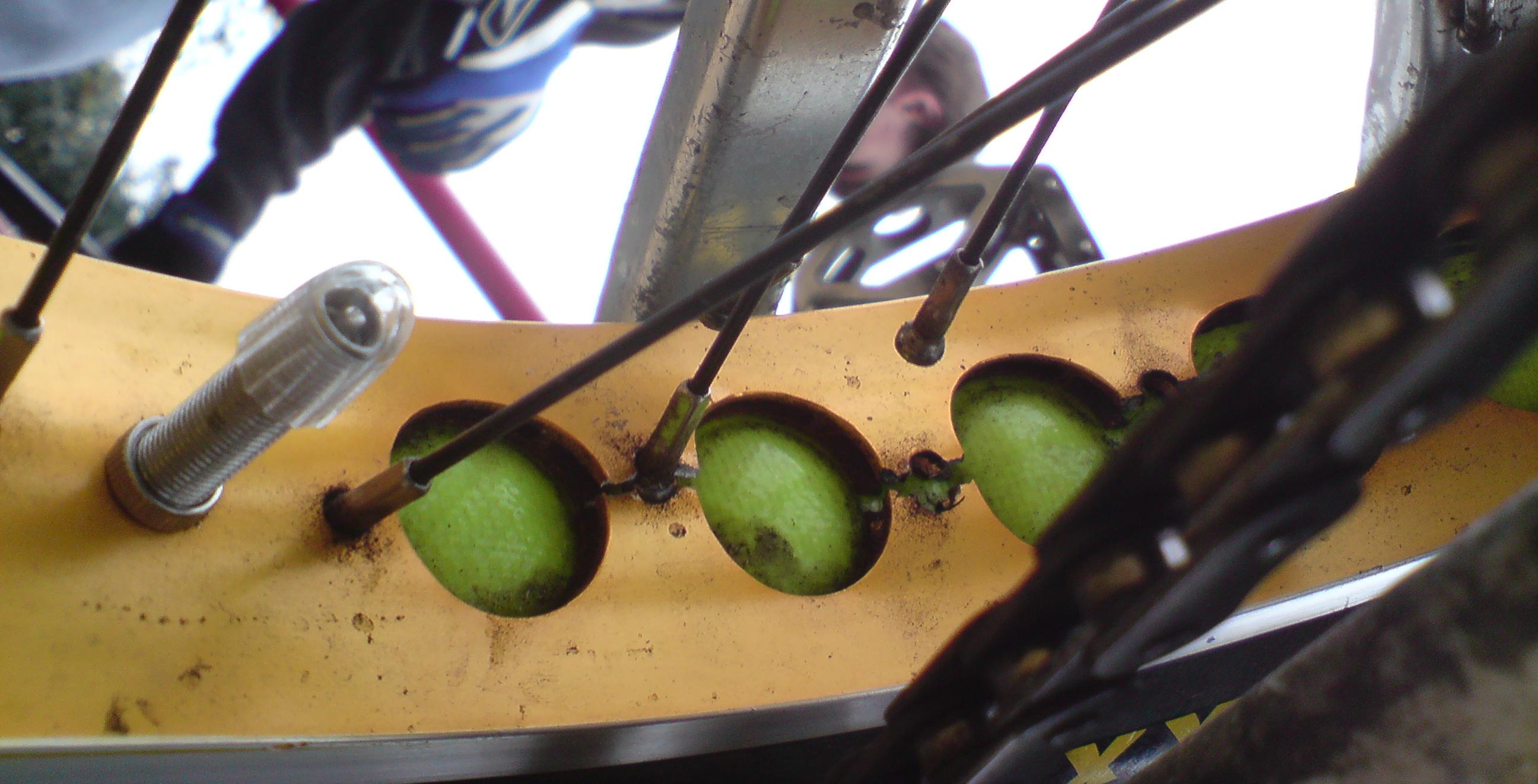

davey1991 Posted December 10, 2008 Report Share Posted December 10, 2008 I've always use drilled rims, I've had no problems with them being weak and they weigh less you should know by now i always catch you out. remeber this stu, broken echo 06 rim. . Quote Link to comment Share on other sites More sharing options...
Sidehop Stuart Posted December 10, 2008 Report Share Posted December 10, 2008 Ooops I forgot about that :$ Look at my new one which came today from Tartybikes! what you reckon davey lol Quote Link to comment Share on other sites More sharing options...
davey1991 Posted December 10, 2008 Report Share Posted December 10, 2008 Ooops I forgot about that :$ Look at my new one which came today from Tartybikes! what you reckon davey lolhubs poo, lol:P still prefer mine .well least your bike will match, oh yer i forgot thats cracked to:P. Quote Link to comment Share on other sites More sharing options...
Dan6061 Posted December 10, 2008 Report Share Posted December 10, 2008 Those 06 Echo rims were seriously weak though, the newer 07 ones are much stronger, and I beleieve the new TR ones (I think) are the same, but with a new name.Drilled rims are fine strength-wise. Quote Link to comment Share on other sites More sharing options...
Sidehop Stuart Posted December 10, 2008 Report Share Posted December 10, 2008 As you can see ... my gold echo 06 did not put up with an 6 step drop gap (pedal hop 6 steps) Quote Link to comment Share on other sites More sharing options...
Connor Powell Posted December 10, 2008 Report Share Posted December 10, 2008 Just Echoing ( ba boom Tshh) What everyone else has said. Drilled rims are fine strength wise, Apart from echo 06 rims which were terrible for snapping. Echo 07 are tough as old boots. Thing you want to look for is how well rims hold a grind. Echo 07 are great for strength and amazing at holding grinds. Try-all rims are fine in strength but not so great at holding a grind, So when you grind it more you going to loose strength. Quote Link to comment Share on other sites More sharing options...

tris Posted January 6, 2009 Report Share Posted January 6, 2009 you should know by now i always catch you out. remeber this stu, broken echo 06 rim. .Damn....unlucky.Nice Dust Cap BTW. Quote Link to comment Share on other sites More sharing options...

Sidehop Stuart Posted January 7, 2009 Report Share Posted January 7, 2009 Damn....unlucky.Nice Dust Cap BTW.Came with the innertube. Quote Link to comment Share on other sites More sharing options...
