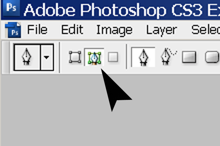

mr ailsbury Posted December 5, 2008 Report Share Posted December 5, 2008 Right!I'm in Photoshop CS3 with a piece of A3 paper in landscape trying to make a double page magazine layout.So I use the pen/line tool to split the page in half which works fine, I then try and add other lines and stuff to the page but as I add new lines the last one i've drawn dissapears They're still all there in the list of layers on the right hand side and when I select one it re-appears but they refuse to work properly and stay on the actual page together, and when I look on the print preview they're all pazzed out and grey! Can anyone tell me why its doing this? and tell me how to sort it out, or an easier way of doing it?cheers Quote Link to comment Share on other sites More sharing options...

Jitters Posted December 5, 2008 Report Share Posted December 5, 2008 (edited) Yep, activate rulers and use the guides or InDesign as mentioned.BUTI do know what you're talkiing about. The pen tool is still in shape mode. Annoying as all hell.Every time you draw and complete a line it creates a new layer. Click on the icon to the right like noted in this pic I've added. Should be good to go then. Edited December 5, 2008 by Tappets Quote Link to comment Share on other sites More sharing options...
Tomm Posted December 6, 2008 Report Share Posted December 6, 2008 What Tappets said.Also, in the paths palette there should an option for 'stroke path' which will turn your path into a 'real' line (on the active layer). You can also convert it into a selection etc. I suppose this would be useful to know if you had already traced a complex path and didn't want to have to redo it. Quote Link to comment Share on other sites More sharing options...
