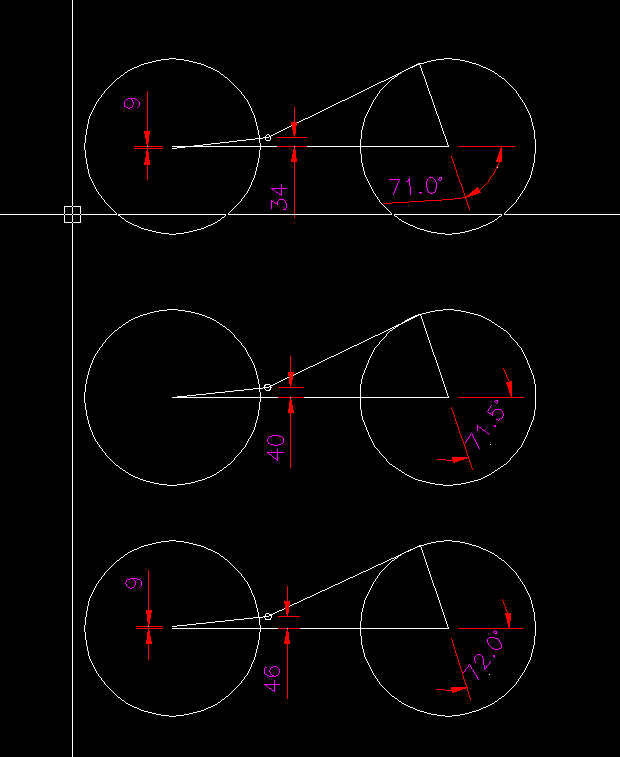

Just sused it.
The more the back wheel is lifted up, the steeper the head-angle and the lower the BB rise.
The BB rise is measured as the distance up (or down) from the straight line wheelbase. If the wheel is moved up in the dropouts, the BB rise will decrease, but the head-angle, as expected will get steeper.
Just sused it.
Nah that isn't right.. I think.
Undo your wheel in your frame and lift the frame up, but keep the wheel in the same place.. The headangle gets steeper and the bb rises..

So - Assuming ...
1084 - 377 - 35 - 71°
1085 - 378 - 40 - 71.5°
1086 - 380 - 45 - 72°
which one are stan and ali going to run ?!
Personally I would go with the steepest head angle - but Im not convinced the difference will be that noticeable ? Just seems they have sacrificed a lot for a very small amount of adjustment ? Tensioner is boss though.
